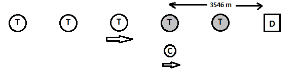

Garbage Trucks, one after the other, are heading for the dump. They move at 19.7 m/s, and every 3 min, 2 of them arrive at the dump. A cyclist, moves at 4.47 m/s, heading for the dump as well.
a) With what frequency do the trucks overtake the cyclist?
b) What if there was a hill, that didn't phaze the trucks, but resulted in the cyclist going at 1.56 m/s. What's the frequency now?
v = Δx/Δt
Well, first of, I decided to find the distance from the starting point of the trucks to the dump.
vt = Δx/Δt <=> Δx = 19.7 m/s * 180 s = 3546 m
Using that, I found the time the cyclist needs to cover the same distance.
vc = Δx/Δt <=> Δt = 3546 m / 4.47 m/s = 793.3 s = 13.22 min
Then I figured that I'd say:
-The cyclist needs 13.22 minutes to reach the end.
-2 trucks need 3 minutes to reach the end.
-So, how many times do the trucks cover that distance in the time the cyclist does?
-So: N = 13.22 /3 = 4.41 times
Now, we have that: In 13.22 minutes, 2 trucks overtake the cyclist, 4.41 times, therefore, 8.82 trucks overtake the cyclist in that timespan. In one minute, how many trucks overtake him?
f = 8.82/13.22 = 0.667
And that's where I get stuck, because the book's answer is: 0.515
Obviously I'm missing something, but I just can't figure out what. As for (b), I'm not sure if the whole drive is a hill, or if it's just a small hill. But it doesn't specify any points or whatnot, so I assume it's the former (trucks keep the same speed all the time, but the cyclist changes his, and it's basically (a) with different numbers).
Any help is appreciated!

Looks like your initial setup at t = 0 is
Do the gray trucks count as passing the cyclist during the time interval between t = 0 and t = 13.22 min?
[EDIT: I see jbriggs444 already pointed this out.]
Well, technically the two trucks at the front aren't really overtaking him. In 3 minutes they'll be at the dump, and the cyclist will be at 804.6 m.

Uhm, at the risk of sounding like even more of a clueless idiot... do I? Is it the 3546 m I found before? 2 Trucks arrive at the same time, so the other 2 behind them are 3546 meters behind? Is that it?
Yes, see the picture in post #3. You can see that the distance between two consecutive trucks is half of 3546 m.
Ah, yeah. But why should it be half of 3546 m? Don't 2 trucks cross 3546 m every 3 minutes? So if the first two arrive consecutively at the dump, the other two will be behind them by 3546 meters. Am I missing something? I figure the "2 trucks at the dump every 3 min" means that the line is compromised ot 2 trucks, side by side, following each other, as in Truck/Truck-Truck/Truck-Truck/Truck. Not Truck-Truck-Truck.
The problem says, "Garbage Trucks, one after the other, ...". That makes me think one at a time rather than side-by-side. However, it shouldn't make a difference. If you pair them, then the distance between the pairs is 3546 m. Then you use the relative velocity to figure out the time interval between two consecutive pairs passing the cyclist. From that you can get the frequency of pairs. The frequency of trucks would then be twice this frequency. You should get the same answer.
I figured that it's a case of pairs, otherwise 2 wouldn't reach the dump at the same time. Anyway, so:
Each pair is separated by 3546 m. Each pair needs 233 s or 3.88 min to cross them (VTC/d). So, every 3.88 min, 2 trucks overtake the cyclist. So, every 1 min: f = 2/3.88 = 0.515. Which fits with the book's answer and my previous one.
