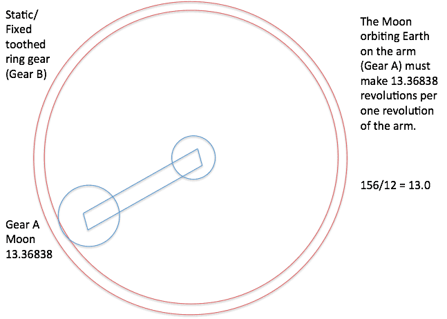

Hello Ladies and Gents,I am look for some help with designing the gear trains for an orrery (a mechanical model of the solar system) I am planning. I need some advice on how to go about calculating the specification of the gears in the mechanism which I will machine. I will use cycloidal teeth I am struggling to understand the relationship between the gear ratio; which I understand to be the "ratio of the angular velocity of the input gear verses the angular velocity of the output gear" and the number of teeth a gear must possesses to honour that ratio. I can’t find a clear explanation of how to determine the appropriate number of teeth a gear must possesses to honour a specific ratio. All of the examples on the Forum have a known number of teeth on one or more of the gears in the train. For example:As in the diagram below; I need the gear that drives the moon (GEAR A) to rotate 13.36838 times per 1 revolution it makes of the fixed ring gear – but how many teeth do I need to reach this outcome. I can guess that 12 teeth on the moon gear and 156 teeth on the fixed ring gear will cause 13.0 revolutions of the moon gear per 1 revolution the arm makes of the fixed ring gear…But this does not get me to the 13.36383 revolutions I need and nor do I find this method repeatable for more complex/less favourable ratios.What is/is there a formulaic method to calculate exact gear ratio into teeth counts?
Many thanks for assistance rendered.
you know that 156/12 = 13
you need to solve x/y = 13.36838
where x and y are the smallest integer solution.
Unfortunately, your moon gear will require fifty thousand teeth...

Thanks for the replies chaps. I see from the rationalization that it is very hard in practice to make accurate systems that are practically machinable. I take it people have always just dealt with this error in clockwork mechanism or designed units of measure that divide rationally into one another.
As a thought, and your feedback welcome - would using pulleys and belts be a more accurate way to achieve finer scale measurements (albeit in low torque applications). I'm thinking that the circumference of the pulley could be an infinitely finer scale (as fine as the resolution of ones equipment) and would allow for non interger ratios that would otherwise restrict one when using toothed gears?

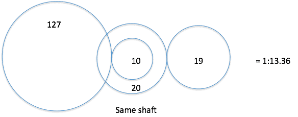

Hi Jack,
So when you developed the 127/10 which is a ratio of 12.7 and multiplied it by 20/19 which is 1.05263 to get 13.3634 what does this do to the gear train in real terms?
Is there now a 127 toothed gear meshed to a 10 toothed gear and then a 20 tooth gear on the same shaft as the 10 toothed gear, the 20 tooth gear then meshes a 19 tooth gear on a separate shaft?
Yes, exactly.

Thanks again Jack, unfortunately this is sinking in quite slowly with me and I have another question related to the above example where we have the 127:10 and 20:19 compound gear chain giving us the desired 13.36 ratio.
Let's imagine for whatever practical reason that a 127 tooth gear is to large (it likey is not, but I'm bound to run into this problem soon or later). So is it possible to turn the 127:10 into a compound gear train that can drive the 20:19 at same ratio of 12.70 (that being 127/10 driving 20/19 giving the overall 13.36)? The output gear of the complete compound train (if correctly calculated) should be turning 13.36 times faster than the input or vice versa depending on the driven-driver - correct?
If the above statement is correct the I can go about making a compound gear train with a 12.7 :1 ratio, but 127/10 has no (useful) commonly divisible values to give whole integers - I think only 1 is common.

What remains is an exhaustive search within a very manageable complexity. We simply go through all A and B systematically checking each fraction multiplied by the (D/C) part that they dictate. We are guaranteed each attempt complies with the reverted gear train requirements thanks to formula (3). We keep track of the closest ratio so far and keep crunching to the end.
The Gear Train Calculator manipulates the final result so that the idler compound gear (represented by the inner two numbers) will contain the lower numbered largest gear. There is no pressing reason for this but just something extra I threw in thinking that this may be desirable.
For a ratio of 12 for example - a very common requirement in clocks as was stated at the outset, the calculator produces 10:30,8:32
Note that 10+30 = 8+32
