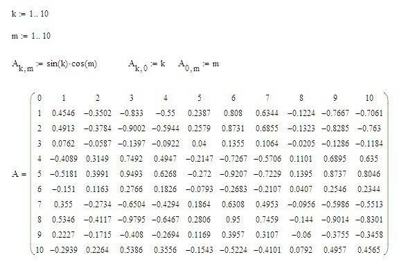

Well, they seem to agree with my Mathcad-generated results, if that's of some reassurance.

  • Mathcad worksheet defining k and m from 1 to 10 and A(k,m) = sin(k)cos(m), with a 10 by 10 matrix A of decimal values displayed below.
Forgot to add, image showing proof of pudding in Mathcad.
  • Mathcad worksheet showing ORIGIN := 1, k := 1..10, theta_k := k, and a 10 by 10 matrix of values for sin(theta)·cos(theta) transposed.
