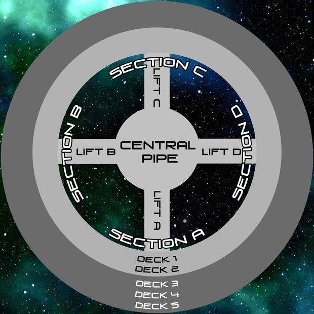

Ring cross section:

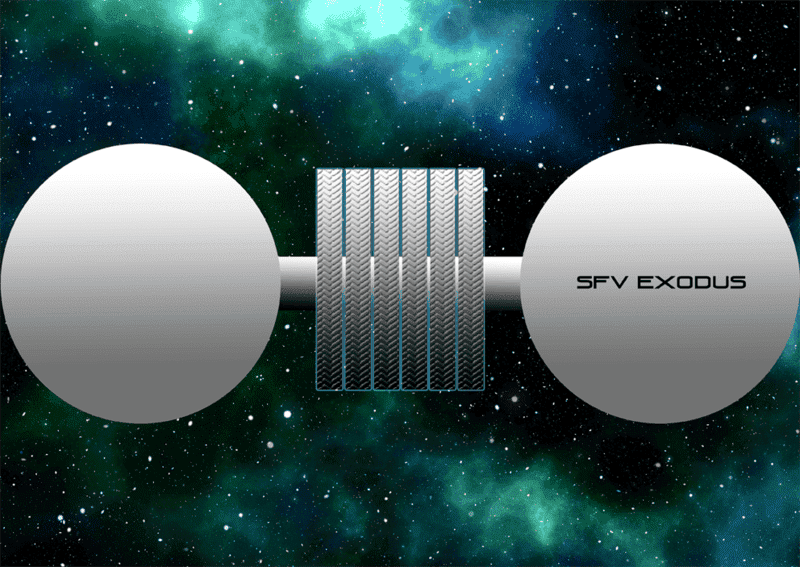

Suggestion 1: Dumbbell Design (rings outside the ship)
DaveC426913 said:
I can see a design that is essentially a dumbbell. A sphere of fuel 1km in diameter and a sphere of water 1km in radius. A cylinder with rings squished in the gap between them. Could also be done with an array of smaller tanks. As long as you can't see stars directly bowward, you're protected.
(not quite to scale; I assume the rings would have to be even smaller in comparison to the spheres at both ends)
As you can see, I've increased the number of rings from the original five to six. I ultimately agreed this is easier than to have the farm ring be twice in mass compared to a regular ring, by extending further inwards. Thus, I'd simply work with two farm rings now.
I've also placed the rings closer together, so that they're now just 5 m apart.
We could either have the rings rotate in opposite directions pairwise, i.e. left-right-left-right-left-right,
or we could have them rotate in a 3:3 manner, with the first three rings rotating in one direction, the next three rings rotating in the other direction.
The central pipe (between the spheres, connecting the rings) is still 100 m in diameter.
The hubs of the rings still rotate inside the central pipe, thus creating 0.2 g in there, compared to the 1 g created on the outer rings (500 m in diameter) themselves.
Here, contrary to Dave's suggestion, the two spheres are still equal in size; the one with the ship name is the one at the front.
@DaveC426913 suggested for the water sphere (the one at the front, to protect against radiation) to be 1 km in radius,
while the fuel sphere (the one at the back?) would be 1 km in diameter, i.e. half as big (see quote above).
I thought it would be the other way round? Since we need fuel to move all that mass of the water, too?
So wouldn't the ship need a much bigger fuel tank (=sphere) than water tank?
The upside of this design is that the central pipe - the section between the spheres - could be fairly short.
Since the sphere for the fuel is so massive that it can be stored in there, we should not need an extra-long trunk of the ship to store the fuel.
Unless we do so for redundancy, of course, in case something happens to the spheres.
Keeping the rings on the outside might make it easier to keep the "dismantling process" I envisioned for the eventual landing of the ship.
When the rings unattach from the central pipe, then break down further into subsections that can enter the atmosphere and form the first "buildings" on the surface. That way, the crew can take effectively all of their equipment and infrastructure with them.
I'll have to come up with some handwaving about how these individual sub-sections of the rings turn into oversized pseudo space shuttles with the proper aerodynamic qualities to enter the atmosphere. For starters, I need additional fuel in the ring walls, or at least cavities in which fuel can be transferred from the big fuel sphere, before the dismantling process begins.
An ice shield in front of the ship would still be required, and it would have to be even larger than the spheres themselves.
Hence, it didn't fit on this image anymore. But just imagine it extends beyond the spheres "in height" on both ends.
So the mass of this ice shield would be immense, compared to the other design.

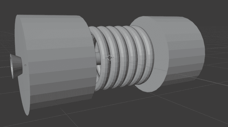

Suggestion 2: Cylindrical Design (rings inside the ship)
John Strickland said:
They are one of the few things that should stick out from behind the ice shield and can have a narrow impact shield along their front edge. The dumbell design would require up to 2 square km of ice shield, whereas the 500 meter thick cylindrical design would require about 1/4 of a square km of ice shield. Narrow designs reduce total ship's mass.
N1206 said:
A cylinder 250 m in radius is going to have to be around 5 km long to contain a cubic kilometer.
This would lead to a much more "boring", but also more straightforward design - and a somewhat suggestive one, for a generation ship in particular. :cool:
Length: 5 km
Cylinder Radius: 250 m
Cylinder Diameter: 500 m
The big difference is that here, the entire outer hull is as wide as the rings in the other design (500 m).
The rings would therefore be nothing but demarcated sections within the cylinder, specialised in certain functions.
The central pipe (the axis in the middle) would be entirely inside the hull, still with a diameter of 100 m.
The question is whether the central pipe would be needed at all, or whether people would just move through the ship on the rotating inner walls, as if they lived in a small O'Neill cylinder.
However, I doubt the entire inside of the cylinder would rotate?
Thus - and this would be most important for keeping the current plot - the ring sections with their dedicated functions (farm, factory, habitat, lab, public) could still exist, but inside the cylinder?
We would still need at least two sections of the cylinder, rotating in opposite directions to prevent the ship from flipping around.
This would be akin to having three rings in succession spin in one direction, the next three rings in the other direction, in Suggestion 1.
In this image I've inserted the ice shield at the front. There is still a sphere at the back, which could serve as a vessel for the artificial black hole if this ship were to use a Kugelblitz drive.
However, would this mess up gravity relations on board? Would everything in the ship "fall" towards the back end, i.e. would gravity point towards the black hole, with the ship standing on top of it like a skyscraper? (Isaac Arthur suggested this in his video on Kugelblitz drives).
The fuel and water would be placed inside the cylinder, in front of the inhabited areas (meaning not just in front of the habitats, but also in front of the lab and public sections).
One upside of the cylindrical design would be the lower mass of the ice shield at the front.
All the fuel would have to be stored in the cylinder, which requires the ship to be much longer.For the mass ratio, let's use these numbers that @John Strickland provided towards the end of the previous discussion:

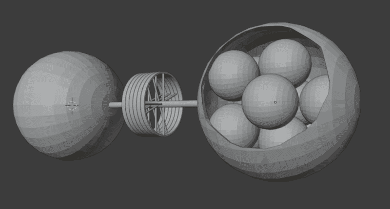

As for arranging tanks, a single huge one is OK, but several smaller ones are more efficient in several ways, not the least of which are:
  • redundancy in case of puncture
  • easier plumbing access to contents
  • less "sloshing"
  • easier to arrange into a wider, flatter radiation shield
etc.
Good point. Couldn’t this same goal be achieved by having further sub-chambers within the giant spheres? So if the hull gets punctured in one place, only everything inside that sub-chamber would be affected, but not the entire sphere.

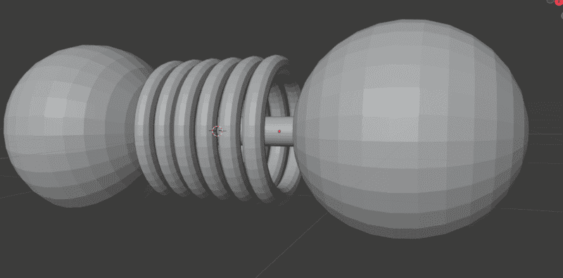

The 3D model you created looks very much like what I had in mind, great job! Here you can see even more of the details than in my 2D depiction from the side. May I ask what software you used to create this model? :wink:

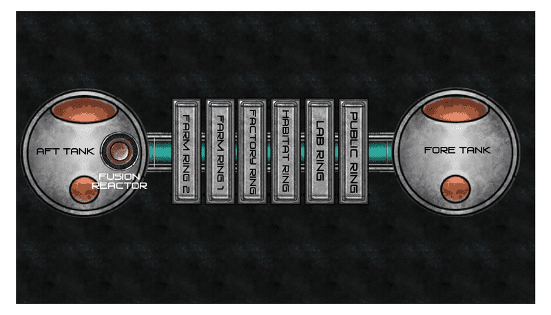

Alternatively, the fuel tanks at the back could consist of several small spheres indeed - so that only one of these would be used for the tiny black hole. And then, for the tank at the front, we could stick to “one large sphere with sub-chambers”. That way, the ship would still look like having a “head”, i.e., more Star-Trek like. Which is actually a pleasant surprise. :). Because I didn’t expect to get away with any ship shape remotely close to those used in Star Trek.To get back to my question from the starting post:
Did I understand you correctly that, in your original post, you were suggesting that the fuel sphere and the water sphere should differ vastly in size? ;)
One having a radius of 1 km, the other a diameter of 1 km?
Sure. Consider the pros and cons of each. (It seems to be from 20th century designs than smaller, multiple systems are generally better than larger singular ones.)
Question though: if the interior is full of sub-chambers, and all the plumbing required to service those sub-chambers then you're got a working system already ... what purpose does the outer spherical shell serve? Why have it at all?
I used Blender, which I've been practicing with. That mockup took me about 2 minutes.
Given the mass the outer hull would add to the ship, that’s a very fair question. We could argue “as a final layer of protection”? If any of the individual sub-chambers break (for internal reasons), there would be a surrounding layer to catch the contents, rather than having them escape into space right away.
But this is a little bit of post-hoc reasoning on my part, to preserve the spherical shape (and the resulting Star-Trek aesthetic ^^) on at least one end of the ship :angel:.
Ah yeah, heard about that one, my father used it for some video-editing things. I might have to look into that software, too! ;)

With one exception:
Back to the two tank design. Now it makes sense.
Your ship looks like this: [Engine][Aft Tanks][Rings][Fore Tanks]
In the accel phase, use fuel from the aft tank.
In the coasting phase crew are protected by the full fore tank.
Before decel phase pipe half the fuel from the fore tank into the aft tank (so the ship is balanced when it gets flipped)
Flip the ship.
Pipe the rest of the fuel from the fore tank into the aft tank, where it will protect crew during decel.
(Sorry if this seems like a wild goose chase that led us back to where we started, but when we came up with the dumbbell design, we had the wrong reasons for it. Now we know why you need two tanks.)
Do we actually need a sphere with a 1 km radius at the front, rather than a disc with a 1 km radius that’s only 10 m thick?
Size and shape of the tank(s) is an unknown. I think you are right, it need not be spherical, but it'll need to be thicker than 10m. After all, it's acting as an ablative shield no? Every particle that impacts it will blow off a chunk like a case of dynamite.
There is no reason to have the tank more than a little wider than the rings. So, rather than a sphere, you could look at a cylinder. That'll provide consistent protection across its surface, unlike a sphere. It's also more compact.
A sphere 1km in radius has a volume of about 4.2 cubic km (that's 2km "long").
A 1km cylinder with the same volume as that sphere is only about 1.3 km long.
(You want your engine to be protected by the shield during decel or it will get bombarded. Have as little of the exhaust out beyond the shield is practical)And all of this has to be thrown out the window when you factor in:
- accel phase - has full fuel complement, and is going .1c
The design you made in Blender (thanks a lot again for that, I appreciate the effort, since it makes all of this a lot easier to visualise! :wink:) manages to still retain the iconic dumbbell design, which I like. Even though it obviously looks less "Star-Trek"-like now, because it no longer has that typical sphere shape reminiscent of the USS Pasteur.
And that sounds like a strong argument in favour of cylindrical tanks. Because while the mass of the fuel contained within would be the same, if the spherical design is longer and therefore requires more ship hull, that will also mean more mass.
It might not look as nice as two spheres, but this just goes back to something I've realized a long time ago: "What's pretty is often impractical." :smile: (And what's practical often isn't "pretty"...)

An interim summary: With the "two-cylinder dumbbell" proposed by @DaveC426913 , we'd be back to the original ship length of about 3 kilometres:
Each cylinder (1 km in radius, 1.3 km in length) + 6 rings, each 64 metres in width + 5 metres in between the rings, as proposed by @John Strickland .
In sum: 2 x 1.3 km + 6 x 64 km + 5 x 5 km = 2.6 km + 0.409 km
Dave's Blender model still shows some distance between the outer rings and the cylinders.
Could we go with another 5 metres here on both ends? Or do we need more space to fit additional equipment in there?
Keep in mind the central pipe has a diameter of 100 metres (=radius of 50 metres).
So pi * (50 m)² * 5 m = 39.270 m³
I'm still wondering where to put the nuclear fusion reactor. All current builds I am aware of seem to be small enough to easily fit within the central pipe, either vertically or horizontally.
The main difference is of course that there is no gravity inside the central pipe, and 0.2 g within the rotating hubs of each ring in the central pipe.
How about a fusion reactor large enough to power a 3km long ship across 12.5 light years? Do you not think it needs to be a little larger?
But if you want the reactor to live in the pipe, then you should probably flip the whole hab section - rings and all - end-over-end at turn-around, rather than detach the rings from the pipe.
To clarify: The rings so far only detach once the ship has already come to a standstill.
What do you mean by "flipping the hab section"? Flipping the centre of the ship, but leaving the sphere or cylinder at the front and back in place? Sounds easier to flip just the entire ship, including "swapping" the front and back sphere / cylinder around, doesn't it? :wink:
