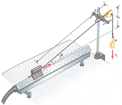

A 1.00-kg glider on a horizontal air track is pulled by a string at an angle θ . The taut
string runs over a pulley and is attached to a hanging object of mass 0.500 kg . (a) Show that the speed vx of the glider and the speed vy of the hanging object are related by vx = uvy, where u = z(z2–h02)–1/2. (b) The glider is released from rest. Show that at that instant the acceleration ax of the glider and the acceleration ay of the hanging object are related by ax = uay.

Draw the triangle incorporating z, ho, and x. What is x in terms of the other variables?
When the hanging mass falls a given distance, what happens to the length of z? How does x change when z changes? How does a change in the length of z relate to the velocity of the falling mass?
Hint: Differentiation is required, and then an application of the chain rule.
