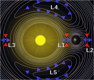

Hey rocketgirl93! :smile:
Suppose you sky rocketed to this mysterious point...
Shall we give it a name?
Let's call it... L1!
(Yes it's actually called L1. :wink:)
Here's a neat picture!
Diagram of the Sun, Earth and Moon system with curved gravitational equipotential lines and blue and red arrows, labelled L1 to L5 for the five Lagrange points, with L4 and L5 at the Earth's orbital position ahead and behind.
Oh, and just to get this started, how strongly would the moon pull at you?

No, it's not.
D H said:
No, it's not.
Oops. You're right.
I forgot for a moment about the centripetal force.
Ah well, it's still a nice picture!
