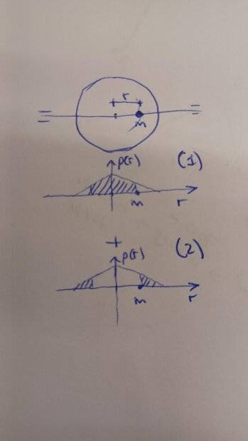

I am trying to understand gravity inside an exponential axysymmetric mass disk with no thickness.
I know there are exact solutions for this case, such as the Mestel disk or the Kuzmin model, but I want to work out a simpler solution.
I am approaching the subject by linear superposition. For a mass m inside the disk at a distance r from the center, the gravitational force experienced by the mass m can be divided into the force from the mass M(r) inside the radius r (1), and the force from the mass outside r (2) (see attached image). Due to symmetry, I restrict the solution to a unique axis.
My understanding is that the total gravitational force experienced by the mass m pointing towards the center to the disk, is smaller than the one applying shell theorem (a spherically symmetric body affects external objects gravitationally as though all of its mass were concentrated at a point at its center). Also, it is smaller than the gravitational forced experienced only by the mass inside the radius r (case (1)).
What about gravitational field intensities? My understanding is that the gravitational field intensity at a distance r is bigger than just for case (1). Is it also bigger than for the case of all the mass of the disk concentrated at a point?

Curve in your figure seems linear not exponential to me. Could you give us formula of ##\rho(r)## ?

It is certainly not. I dont care much about the form of surface density (linear or exponential) as long as it is not a solid disk (which is a completely different case of study).

I am solving it through superoposition. Isnt there a more simple way to do it?

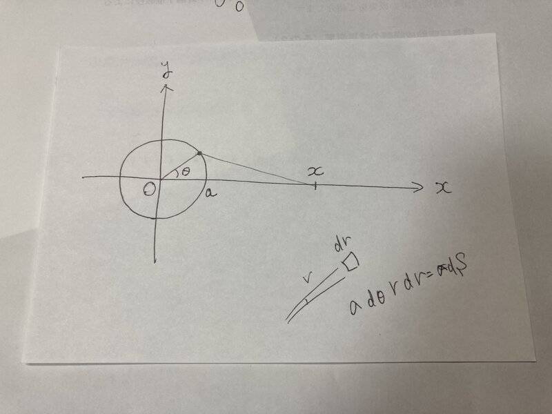

Not only inside disk and outside ring of your suggestion, but decomposition to the inifinitesimal rings seem to work.
On X-Y plane there is a ring of radius r centered on Origin. Gravity potential at (x,0) is
d\phi(x:r,\sigma)=-Gr\ dr\ \sigma \int_0^{2\pi}[r^2 \sin^2\theta+(x-r\cos\theta)^2]^{-1/2}d\theta
where ##\sigma## is surface density of mass. x<r, x=r and x>r work. Gravity potential of disk which consists of the rings is geiven by superposition,i.e.,
\phi(x)=\int_{r=0}^{r=\infty} d\phi(x:r,\sigma(r))
I am afraid there is no simpler way as you expect so.

If it is axisymmetric, why bother with angles?
Disance to the observing point depends on the angle. After integration the result contanins no angle parameter because of symmetry.
