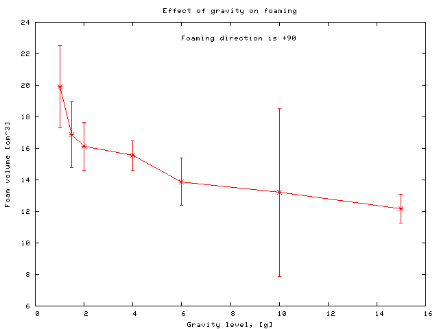

Dear all,
What do you think, how the gravity effects on the structure of aqueous foams?
I' ve just made a series of http://www.admatis.com" , Bremen, Germany.
There are a lot of experiments available in micro-g, using parabolic flight missions.
I would be happy to discuss with you the recent results and the open questions!

Dear PhysicsForumers,
I am sorry that I answer so late. I think quinn is right, we can expect that gravity level has a small effect (but it do have some!) on foam evolution because the effect of gravity is proportional to the mass, and foams have small mass.
Here is a little article about foams, (sorry for my bad English.:frown: ) see the attachment. It will appear on the website (with pictures) I linked in the http://www.admatis.com" . For starting, one of the best article about the physics of foams is the so called Making, Measuring and Modelling Foams, by Denis Weairie and Stefan Hutzler, Europhysics News, May/June 1999.
A lot of experiments has been carried out in micro-g, to obstruct the gravity-driven drainage, and to achieve stable foam structures even from materials that are unstable on Earth. we tried out, what happens in macro-g. We could not measure the cell wall thickness inside the foam, we only monitored the foam heights. We expected that with increasing gravity levels it is more difficult to create foams. :bugeye:
It is true. See the the plot below, made from raw data. I am looking forward to evaluate all of our measurements and to clarify the effect of macro-g.
Hopefully, there will be detailed results within a few months.. :rolleyes:
