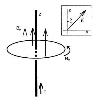

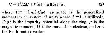

Hi,
I have this article in which I saw that for a spin 1/2 particle confined to move along a ring positiond in a magnetic field with a z and \varphi
The Hamiltonian is given by: (in second attacment)
What I do not understand is how do you get the last term in the Hamiltonian.
Any help?
Thanks in advance

It comes from the standard spin-orbit coupling between the particle's magnetic moment, usually written as [tex]-\mathbf{\mu}_0\cdot \mathbf{B}[/tex]. You can find a treatment on this in any book on quantum mechanics. Here, [tex]\mathbf{\mu}_0[/tex] is the magnetic moment of the spin-1/2 particle (not equal to the [tex]\mu[/tex] used in your text)
Now, to obtain the form they use you use the fact that you are dealing with spin-1/2. In that case the magnetic moment [tex]\mathbf{\mu}_0[/tex] can be written as [tex]-\mu \mathbf{S}/\hbar[/tex], where [tex]\mu[/tex] is, again, called the magnetic moment (confusing!). Furthermore, [tex]\mathbf{S}[/tex] is the spin operator which for spin-1/2 particles can be represented by the pauli matrices:
[tex]\mathbf{S} = (S_x,S_y,S_z) = \frac{\hbar}{2}(\sigma_x,\sigma_y,\sigma_z)[/tex]
Plugging this into the spin-orbit coupling reproduces the term from the article, up to some constants. But you can absorb these all into the prefactor by redefining [tex]\mu[/tex] (since this is just some numerical value anyway). Hope this helps!
Thank you for your reply. By the way it was mentioned in the article that h bar was taken to be 1
