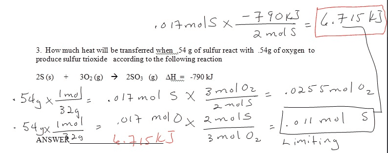

This was a quiz in real life. The teacher provided us with the work and answer for each problem. I uploaded the work and answer for this particular problem in an image file:
Your teacher is wrong. At the top of the paper he is treating S as though it were the limiting reactant. It isn't.
Tom Mattson, I greatly appreciate the speedy and helpful assistance, I will inquire about this question from the teacher.
