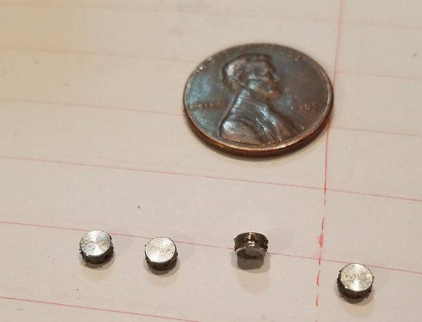

We changed the oil in son's automatic transmission today, a 2001 Ford Explorer (4.0l v6 4wd) .
Oil was dirty , but no bronze or metal shavings in filter just the fine powder-sludge you expect to find on the magnet.
But we found five of these little discs in the bottom of the pan. They're non magnetic.
It shifts way more smoothly after the oil change, emits no strange sounds.
Does anyone recognize the little discs? If so, are they harbingers of doom?
four shown, one is in the grass. you know how that goes...

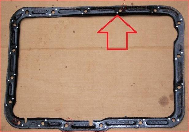

Thanks guys
OCR nailed it it's the spacers for the pan gasket as explained on those Ford forums..
which suggests to us that transmission still had original filter and oil after 178,000 miles . Must be a pretty good one.

thanks again guys , i would have obsessed over those little disks. New gasket either doesn't have them or they are covered and don't show .

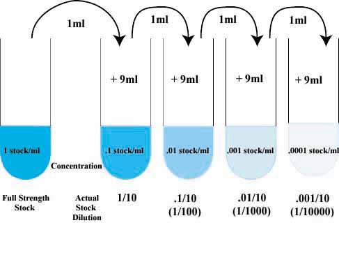

We could make it a bit more scientific by introducing the concept of Serial Dilution : http://biology.kenyon.edu/courses/biol09/tetrahymena/serialdilution3.htm
I made a worksheet that allowed the insertion of total transmission volume and usual change volume and produced a graph whereby I could see by which iteration of dilution an acceptable (to me) dilution had been achieved. Unfortunately that's a couple of OS installations ago and no backup, however not difficult maths.
