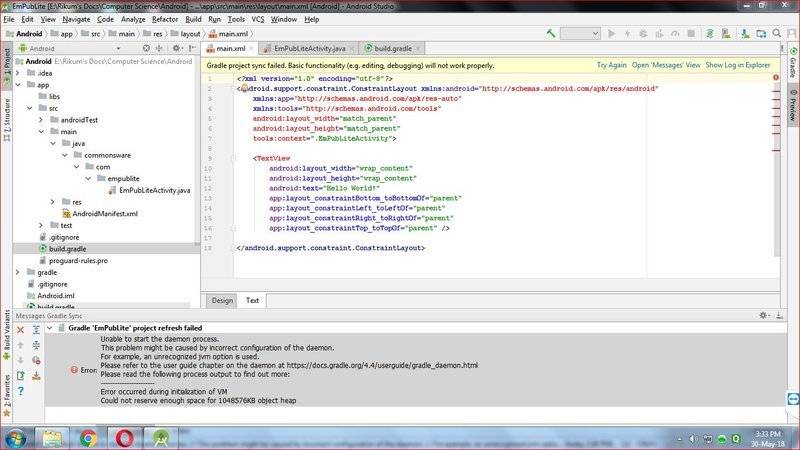

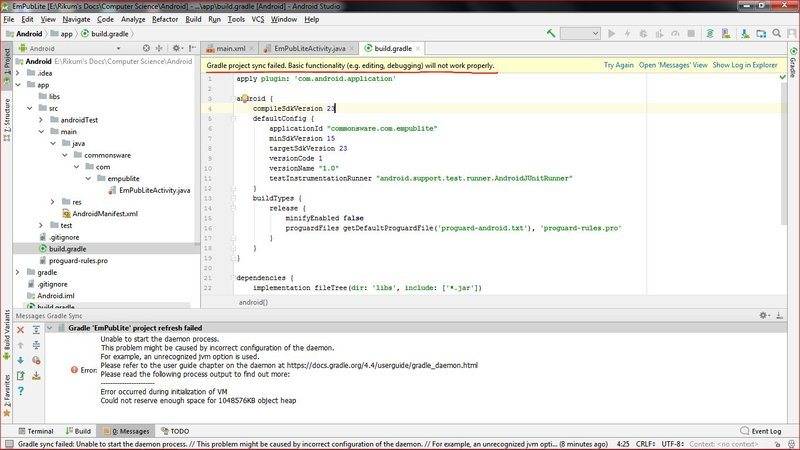

This is the fifth time I am setting up Android Studio. I have downloaded the standalone zip for 32 bit computer from the official website. The android SDK is in G: drive, while the Android Studio files are in C:.
I have set up Android Studio, and set the SDK location to the required folder in G:. I have created a project with minSDK as API 15, and compileSDK and target SDK are both API 23. I have doneall this with instructions from this book: "The Busy Coder's Guide to Android Development" by Mark L. Murphy.
I am facing the same problem as the last time. It's saying that gradle build has finished with errors:
Can anyone please help me out?

I didn't even write a line of code. I created the project, and from that time, it's showing that there was an error in building the project, while the book says that it should compile properly.
I can provide the error messages if you tell me how to find them.
I see, code could not reserve enough for the huge object space. Why the huge object?
So, if you didn't write any code, what is being compiled?

I think so. I just found this:
Let me see if that works.
Nope. It is not working.
I'm getting this error:
Unable to start the daemon process.
This problem might be caused by incorrect configuration of the daemon.
For example, an unrecognized jvm option is used.
Please refer to the user guide chapter on the daemon at https://docs.gradle.org/4.7/userguide/gradle_daemon.html
Please read the following process output to find out more:
Error occurred during initialization of VM
Could not reserve enough space for 1048576KB object heap

It's not a problem with the SDK. The problem is with the gradle, and that is present in the folder of Android Studio in C: drive. Somehow the IDE is unable to sync with the gradle, even though necessities like Internet are available throughout the process. Command prompt can access the gradle properly too.

@Paul Colby wanted to let you know that the problem has been solved. The actual problem lay with the JDK, because the IDE was trying to work with a deprecated one. Gradle build could finally start properly.
Kind of surprised (and not) that the IDE couldn't check the java version and politely inform you that it's out of date. Glad you got it working.
