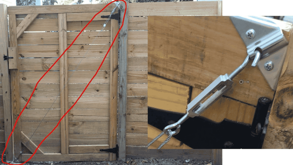

I am installing a garden gate at the back of my house.
The length (L) of the gate is 1.7m and the mass is 62.6kg, there are 2 hinges positioned 1.3m apart.
The gate has an inherent sag, such that, the bottom corner on the unhinged side is 5cm lower than the corner on the hinged side.
What upward force(to be provided by a spring loaded wheel) is required at the unhinged side to ensure the gate is horizontal?

Would the weight be carried equally on both sides? I was thinking that since the hinged side is fixed, this would then become a question of torque and the resultant vertical component?
I would remove the deformation of the gate by installing a wire-rope with a turnbuckle, running it between anywhere close to the point of anchoring to the top hinge and the opposite bottom corner of the gate.
You will basically have a triangle shape which weight will be pulling from the top hinge (anchorage to gate and post needs to be robust) and pushing against the bottom one.
The main problem with wheels are a non-flat=level surface along its trajectory, as well as a twisting effect on the gate each time it is pushed by hand to open or close.
If you still install the wheel, you could loose the anchors of the bottom hinge some and see by the formed gap how much height you can use for wheel with spring before it starts overstressing the bottom hinge (pulling it out from the post).
As @Lnewqban already pointed out, the problem is the misplaced diagonal brace of the gate. This way that brace has compression and it will easily deform together with the gate. It's better to have tension/strain. Preferably with adjustable length. The wire rope (or a thin metal bar) across the other diagonal is actually a very good idea. You can add a turnbuckle strainer.

Place a car jack (or blocks) under the sagging end to make it just above level.
Then run a heavy-gauge double strand, twisted wire from the upper hinge location diagonally across the gate down to the bottom of the drooping end. Fasten very tightly and securely. This should hold it up.

Yes! I was just about to suggest adding a turnbuckle to the suggestion by @AZFIREBALL :smile:
