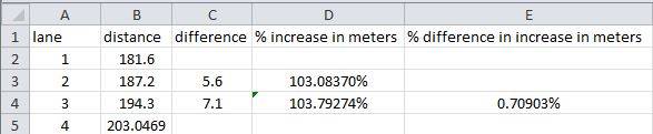

In the winters, I run on an indoor track, and use a footpod to calculate my distances with my GPS watch.
The facility has three lanes, inside #1 is 181.6 meters, middle lane #2 is 187.2 and outside #3 lane is 194.3 meters long. The track is more less rectangular shaped as opposed to a circle, but with circular corners.
I try to calibrate my foot pod with roughly 5 laps to 1 KM, so I run where a 4th lane would be, if it existed. My simple calculations have the imaginary 4th lane at about 203 meters. I arrived at this figure by taking the percentage increase of each lane - lane #2 is 103.0837% of #1 and #3 is 103.7927% of #2. The difference in % increase between #2 and #3 is .7090%.
So I arrived at 203.0469 meters for #4 by multiplying #3 distance of 194.3 * (103.7927% + 0.7090%) - in effect adding the percentage difference from #2 to #3 to #3's percentage increase compared to #2. To clarify more I've attached a screengrab of my calc's in excel. (Column C is difference in meters from #1 to #2 and #2 to #3, and was not used in calc's for #4, column D is each lane divided by the lane inside it, formatted to percentage)
Did I use to correct formula to arrive at the distance of a 4th lane?

There is no way to tell without a sketch of the lanes. In particular, lane 4 could be everywhere.

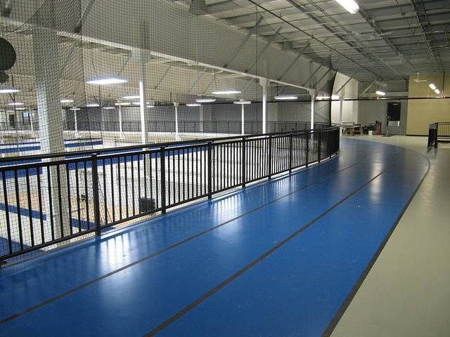

I don't have a sketch on hand, but basically picture a square track with rounded corners, all lanes follow the same path, including the imaginary lane 4
Here is an image of part of it, just picture 3 more corners like this, and another blue lane on the outside that would be lane 4
If we make the assumption that your measurements for lanes 1,2,3 are correct (within 0.1m error) and that the circular part of the track is completely circular, then we run into the problem that the difference between the distances in lanes 1 and 2 should be equal to lanes 2 and 3. Since they are not, then either or both of these assumptions are incorrect.

edit: I just caught the part about the track being square with rounded corners. Any more finer details on this? If you figure out how long the curve of any corner of the track is, then we can figure out the entire track's dimensions - assuming the corners are circular.

Well I never said that. In fact, an identical percentage increase isn't possible because this problem isn't geometric (each lane can't increase at an equal rate).

Sadly, no. Your approach would give a good estimate, but it would really start to break down if you wanted to calculate the -10th lane (a very small lane), or the 100th lane for example.

If the lanes have the same width, their absolute length difference should be the same (like 6m in this example). To be more precise, the length difference should be 2 pi times the width of the lanes. I would expect large uncertainties in the measured values given in post 1.

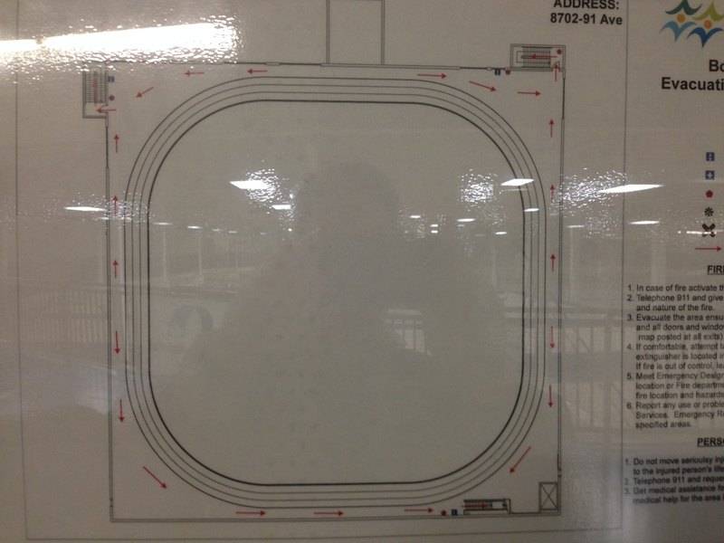

Ok, here is a picture of the sketch of the track - there is no measurements but it gives you the shape of it.
Ok well with that shape, each lane should still increase at a linear rate. You're going to need to accurately measure at least 1 lane, and the width between each lane. With this info and that drawing, I could give you the details about the rest.
