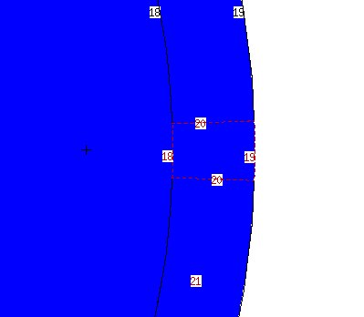

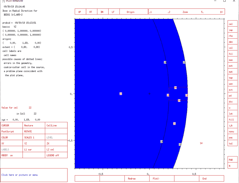

I need some help defining a tally volume. I want a volume bounded by three surfaces, but when I do an initial plot the volume is in red dashed lines. I know that each cell needs to be uniquely defined, but I am not seeing how my volume is not unique. The cell in question is cell 200 in the code. Any hints would be great.CODE

I created the end of the universe as you suggested, but cell 200 is still in red dotted lines suggesting a geometry error. I have attached a picture of the cell in question.

Cell 200 is everything outside radius 1.9 (surface 18), inside radius 2.1 (surface 19), and inside surface 20, a cone.
But cell 21 overlaps with that, since it's all between those spheres except for what is excluded by the cylinder defined by surface 10. So you could exclude the cone from cell 21.
old
21 2 -0.00125 -19 18 10 IMP:p,e=1
new
21 2 -0.00125 -19 18 10 20 IMP:p,e=1
