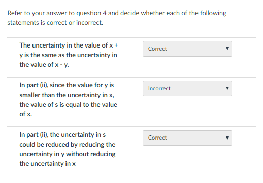

Here is question two. Two of these are wrong. I think that part b and c need to be swapped, but I'm not clear on why.

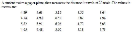

Table of 20 paper plane distance measurements in metres, in four rows of five values, preceded by the sentence describing a student's paper plane trials.

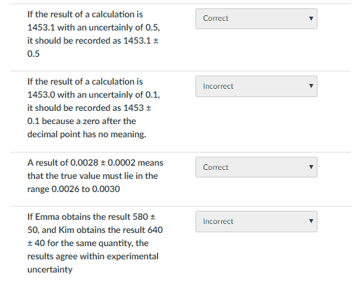

Sorry about that. I guess I was trying to keep from writing a small essay. I'll go through my reasoning for each, but I'm sure you'll find my reasoning to be quite flawed. I would like it if you could pick me up on where my reasoning falls short so that I can improve my understanding of these questions.
Question 1a
If the result of a calculation is 1453.1 with an uncertainly of 0.5, it should be recorded as 1453.1 ± 0.5
I answered true to this, because the decimal places match, so this should be correct notation.
Question 1b
If the result of a calculation is 1453.0 with an uncertainly of 0.1, it should be recorded as 1453 ± 0.1 because a zero after the decimal point has no meaning.
I answered false to this, because the decimal place in the value is important as it shows precision. Also, as before, the decimal places need to match.
Question 1c
A result of 0.0028 ± 0.0002 means that the true value must lie in the range 0.0026 to 0.0030
Perhaps this one seemed too straightforward here, and misled me. I answered true to this one. It seemed that the +- should give the values between the range [0.0026,0.0030]
Question 1d
If Emma obtains the result 580 ± 50, and Kim obtains the result 640 ± 40 for the same quantity, the results agree within experimental uncertainty
I answered incorrect to this, as the values for the second one could be much higher for the first. However, upon re-thinking this one, I think it would make sense fot this to be correct, as the values overlap, and the true value would lie within the overlap.
Question 2a
The uncertainty in the value of x + y is the same as the uncertainty in the value of x - y.
I answered true to this, because since uncertainty is +-, it shouldn't matter if we are adding or subtracting. The uncertainty will add either way
Question 2b
In part (ii), since the value for y is smaller than the uncertainty in x, the value of s is equal to the value of x.
Printed quiz question 4 part (a) and (b): find s = x + y and Δs for x = 2.56 ± 0.01 m, y = 0.26 ± 0.04 m; x = 5 ± 1 kg, y = 200 ± 10 g; part (b) find s = x − y and Δs for the values in (a)(i).
I answered incorrect to this one, because the uncertainty could be either positive or negative. However adding y to x will result in x being increased positively. Therefore, I considered this to be false.
Question 2c
In part (ii), the uncertainty in s could be reduced by reducing the uncertainty in y without reducing the uncertainty in x
I answered true to this, because adding two numbers with uncertainties should increase the uncertainty. However, if I was incorrect in Question 2b, then I would probably be incorrect in this one too.

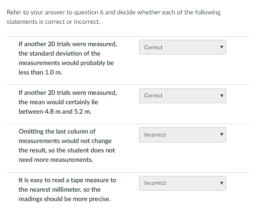

Question 4a
If another 20 trials were measured, the standard deviation of the measurements would probably be less than 1.0 m.
Table of 20 distance measurements in metres for a paper plane, arranged in four rows of five values, from 3.64 to 6.52.
I answered true to this, because I calculated the standard deviation to be about 0.76. This was already well under 1 meter, so more measurements would almost certainly keep the standard deviation under a meter.
Question 4b
If another 20 trials were measured, the mean would certainly lie between 4.8 m and 5.2 m.
I answered true to this, because I calculated the mean to be about 5.04m. Since this is between 4.8m and 5.2m I concluded that this should not change much with more measurements, provided they are not wildly different. Therefore, I answered true.
Question 4c
Omitting the last column of measurements would not change the result, so the student does not need more measurements.
I answered false to this, but I'm not sure about it. I answered false because although a small number of measurements should give you a good idea, I would have thought more measurements will always make a more complete picture.
Question 4d
It is easy to read a tape measure to the nearest millimeter, so the readings should be more precise.
I answered false to this, because I thought that the taking averages should more or less cancel out some degree of precision here. Perhaps I'm wrong.
Your answers look reasonable to me. One could argue that the value of y is insignificant compared with the error in x, but what if y were 0.9kg±0.01kg?
TheFallen018 said:
The next part has one wrong.
Again, I agree with your answers. How have you been taught to calculate uncertainties in products and ratios?
TheFallen018 said:
The first question seemed strange because with just those measurements the standard deviation was already well below 1m.
It is not clear whether they mean the s.d. of the new 20 measurements or of all 40 taken together.
Either way, the new s.d. could exceed 1.
Your answer looks right to me.
TheFallen018 said:
Question 1b
Perhaps they mean merely that the .0 is unnecessary since you are specifying the uncertainty as ±0.1
TheFallen018 said:
Question 1d
Right.

TheFallen018 said:
Question 4b
But it says "certainly"
TheFallen018 said:
Question 4c
We are not told why the student is collecting the data, so impossible to say what is needed.
TheFallen018 said:
Question 4d
The readings could be more precise, but whether they should, again, depends on the purpose. Besides, the s.d. of the results is far more than 1mm, so with hindsight it would have been pointless.
Thanks for your response. I'm really grateful for the help.
I've been taught to multiply two numbers with uncertainties like this.
(x ± ∆x)*(y ± ∆y) = x*y ± (x*∆y + y*∆x)
Does that look right?
I might have accidentally omitted some detail for question 4. The question is about a student who has made a paper air plane and is trying to determine "the best estimate of its average flight distance with it's error".
Looks fine, and certainly supports your answers.
