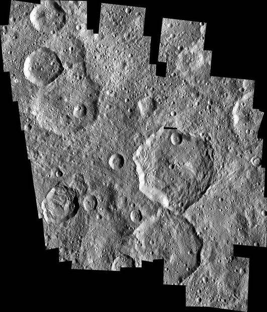

On airless rocky worlds, why are so many craters hexagons? There are even some pentagons. I see them on the Moon, Mercury, Ceres, Mars, Mimas... It's quiker to note the airless worlds that don't have have hexagon craters.
This one is Ceres.
We can use this thread as an image repository for hexagonal craters.

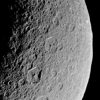

Mimas with its large hexagon crater 'Herschel'
Well I don't see the green marked one as hexagonal but a semicircle with two flat side. The brown bottom left one is a polygon of at least ten sides. So even the two of us can't agree on the shape of some craters on the picture in post #3.
On the picture on post #4 I also don't see the big crater as hexagonal, it is somewhat a complex shape. It's also a complex crater:

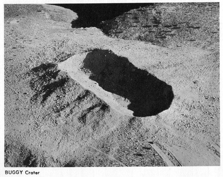

My second favorite nuclear cratering experiment
Before anyone gets too excited about the shape, it is from 5 detonations.
