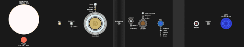

TL;DR Summary: I wrote out a description of a fictional solar system and am looking to see what I would need to change / alter to make it more realistic
A while ago I have written a description for a fictional solar system and commissioned a visual artwork for it. This is a project for my own personal use, and I've always wanted to create something that could actually exist within fictional works.
I am looking for someone who knows a bit about orbital mechanics and stuff to help me with altering, or changing things in this description to be more scientifically plausible. I am not very well versed in orbital mechanics or mathematics. I am curious what orbital periods people would think these planets would have, knowing the setup of the twin suns - if the Stars themselves would be able to host a planetary description such as this. If there is something unrealistic in this setup, I want to know what it is and how it could be changed to be more realistic.
Do note - the Dwarf Planets in the Outer Asteroid Belt are not displayed in the graphic. Feel free to ask questions about this!

(Disclaimer: I have only read the initial part of your long post).
I believe there is still consensus that a solar system (like ours) where the planet more or less follow a Titius-Bode law is a form of tell-tale indicator for a long-term stable solar system, i.e. a system where small perturbations of a planets orbit from bodies already in the system does not escalate into it or other major bodies getting ejected, but via some resonance effects "absorbs" the perturbation. Having two central bodies (stars) is of course a major difference with our solar system, but my guess would be it still would make sense to to refer to a power law for "in-story arguments or background knowledge" regarding classifying the system as stable.
Alternatively you can follow the long time-honored tradition of sci-fi and simply avoid providing enough details on your solar system (i.e. mass ratios, and orbital parameters) to deny anyone to actually calculate and pronounce your system as unstable.

The only one in the habitable zone for Earthly life is Halycon. The others are not in the habitable zone, and are located further out beyond it.

Well, I read through about half the post and didn't see any egregious errors.
I would be curious if there is any suggestions you would like to make for what could be improved to be more realistic?

Nothing that I can think of. It seems realistic enough to me.

Shinespark is a K1V star with 86% the mass of the Sun, while Valey is an M3V Star with 36% the mass of our sun. Shinespark has luminosity of 41%, while Valey has a luminosity of 0.016% of our Sun. So yes, significant differences in brightness.
As for the two stars absorbing each other, that I don't know. Another concern I had was whether or not with the two stars being that close to each other, if that would generate massive flares and solar wind that would render the system uninhabitable.
Originally I had a setup in mind for this system being around a Red Dwarf star, with Halycon as the main Earth-like planet being tidally locked, but having a slightly eccentric orbit to where it's sun wouldn't be locked into one place in the sky, in a manner like this. But then I thought of the two-star setup as you see it now, the best that I could.
http://www.worlddreambank.org/L/LIB.HTM
It appears that you have the plane in which the two stars orbit one another [I'll call it the "star plane"]perpendicular to the ecliptic, the plane in which the planets orbit the stars. Nobody knows how binary stars form so I guess that's possible. Then the planets will at some point in their orbits be passing through the star plane and the stars will occlude one another.
Am I correct in thinking that the diagram is for a different scenario?
@Hornbein
The planets in this system orbit along the equator of the binary stars, so the stars will constantly be occluding one another seen from the point of view of the planets.
The diagram shown is an example of another potential setup I had in mind, it's not mine, just a representation of another possible outcome I may go for, if the two-star setup isn't realistically habitable.
