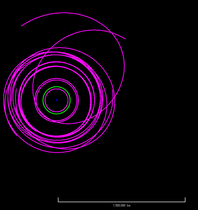

You'd have to define how round is round. The Earth's Hill Sphere is about 1.5 million kilometers. The Moon orbits the Earth about 1/4 of the way to the edge of the Hill Sphere, and its orbit is pulled slightly out of round. The further out you go, the more your orbit is pulled out of round.
Here is a screen shot from a simulation:
http://orbitsimulator.com/gravity/images/ehs.GIF
The Moon's orbit is green. For simplicity, it is set to round, and it is massless so it won't perturb the other objects. 10 test particles are added at various distances from just inside the Moon's orbit out to just over 1/2 of the Hill Sphere. They were all started out in round orbits, but pertubations from the Sun cause them to be immediately pulled out of round. You can see that the deeper they sit inside the Hill Sphere, the rounder they are. As pervect points out, they stay pretty round out to about 1/2 of the Hill Sphere.
