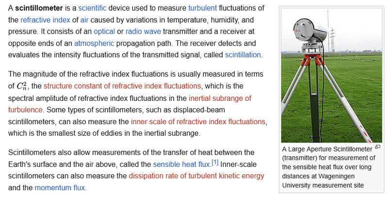

I will detect photons coming through the hole using a scintillometer,
Are you sure that is the instrument you want to use for detecting single photons in your experiment?
https://en.wikipedia.org/wiki/Scintillometer
Hmmm. No. I mean a photomultiplier. I beg pardon - last time I saw a scintillometer it was joined to a photomultiplier and I guess I got confused.
I mean something like a Hamamatsu Photomultiplier and counter, for example.
Sorry, Chief.
