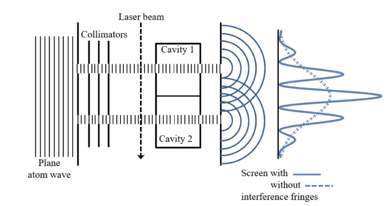

The SEW Experiment, named after its authors, Marian 0. Scully, Berthold-Georg Englert &Herbert Walther, was published in 1991 under the title, "Quantum optical tests of complementarity," and can be found here: https://www.nature.com/articles/351111a0.pdf
They built atom interferometers with detectors and used caesium atoms instead of photons or electrons. A couple of well defined beams of caesium atoms are sent towards a double slit, eventually to end up at a back screen. Before each slit are micromaser cavities that the beams must pass through. A laser beam can be turned on or off to excite the caesium atoms into a higher energy level, such that when an atom enters a micromaser cavity in an excited state it will emit a photon which is then stored in the micromaser cavity. Thus, which-way information can be obtained by reading out whether the photon is in cavity 1 or cavity 2.

If the laser is on, they got a particle pattern. If the laser is off, they got an interference pattern.

ChadGPT said:
TL;DR Summary: Have you heard of the SEW? Do you find it significant?

You seem to be missing one very important point: This is a review article (not a regular one) and they never did these experiments. As pointed out by DrChinese these are just "gedankenexperiments", which were never actually performed at that time. They just present the results expected from calculations. The only experimental data is figure 2 - the interference pattern produced by slow neutrons in a double slit. If I remember correctly, later on some somewhat related experiments with Rydberg atoms were done, but not exactly in the way suggested by Scully. I might be wrong, though. I did not follow the literature too closely in recent years. However, to the best of my knowledge people used other implementations because Rydberg atoms are incredibly sensitive to external fields and it was close to impossible to keep the surfaces of the cavities free from any remaining charges. The interaction between these harges and the Rydberg atoms is an effective which-way measurement.
