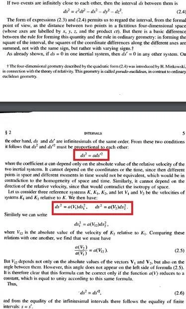

Hello!
I have a problem with understanding homogeneity of the space.
In the book Landau&Lifshitz it was written that two spacetime intervals differ by constant ##a##: ##ds'^2=ads^2##
The coefficient ##a## can't depend on coordinates or time of interval because this violated homogeneity of the space.
My questions are:
1. Could anyone explain on the examples what does "violated homogeneity of the space" mean in this case?
2. How does dependence of coordinates and time of the interval violate homogeneity of the space?
As hard as I tried I couldn't understand it many times.
Thanks.

Ok, so their ##ds## and ##ds'## are describing the same infinitesimal spacetime interval in flat spacetime, just in two different inertial frames.
The homoegeneity of space and time, i.e., spacetime. That just means that the way two different inertial frames are related to each other has to be the same no matter what point in spacetime we look at.

Mike_bb said:
In other source "homogeneity of space and time" means homogeneity of space and homogeneity of time. Not a spacetime.
Homogeneity of space means invariance under purely spatial translations. Thus if you have two events whose coordinates are ##x_a## (##a=0,1,2,3##) and ##x_a+dx_a##, and two other events whose coordinates are ##x'_a## and ##x'_a+dx_a## (##x_0=x'_0## for a spatial translation) then you want the ##ds^2## between the two pairs to depend only on ##dx_a##, not ##x_a## or ##x'_a##. Otherwise, it isn't invariant under translation.
You can make the same argument with ##x_0\neq x'_0##, ##x_i=x'_i##, ##i\neq 0## to insist that ##ds^2## can't depend on ##t##.
I think that gets you to ##ds^2=Adt^2-Bdx^2-Cdy^2-Ddz^2##. Isotropy (rotational invariance) tells you ##B=C=D##, and requiring the frame invariance of ##c## gets you ##A=c^2B##.
I think that's right.

Restating my argument, consider two events with coordinates ##x_a## and ##x_a+dx_a## and two other events with coordinates ##X_a## and ##X_a+dx_a##. As I argued, homogeneity of space and time, isotropy, and the requirement that ##ds^2=0## for light tells you that ##ds^2=B(c^2dt^2-dx^2-dy^2-dz^2)##, where ##B## can't depend on the coordinates.
You can make the same argument in another frame and obtain ##ds'^2=B'(c^2dt'^2-dx'^2-dy'^2-dz'^2##. I think then that the "infinitesimals of the same order" allows L&L to write ##ds'^2=a\,ds^2##, where their ##a=B/B'##

What Ibix wrote gets you to the first highlighted eqn in the image of your post #3. You have to follow the rest of L+L arguments to get to the final eqn 2.6.

If the space is homogeneity and isotropy we can use the fact that arbitrary point can be translated or rotated to any point. From this we can conclude that coefficient ##a## between ##ds'^2## and ##ds^2## doesn't depend on coordinate (and time).
You need only homogeneity to show that ##a## does not depend on coordinates. You use isotropy to show that ##a## can only depend on the magnitude of the relative velocity (##V_1\equiv \sqrt{V^2_{1x}+V^2_{1y}+V^2_{1z}}##) between the two frames. These statements are made below the first highlighted eqn in your image in post #3.

It's a bit loose.
I would simply say: if space and time are homogeneous then we can conclude that ##a## in ##ds^2=ads'^2## does not depend on the coordinates (or time).
In other words, in post #20 you have to call out time homogeneity (not just space) and you can drop isotropy since it's not needed there (it's needed for other parts of the overall argument).
