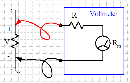

It's a matter of practical design and circuit laws. If your meter movement is as described in this problem, a milliameter that has a 50 Ohm coil resistance and it takes 10 mA for a full scale reading, the maximum voltage it can read is 0.5 Volts. If you connect it to anything greater it is likely to burn out. So the idea of putting a resistor in series with it to limit the current and form a voltage divider makes sense. Putting a resistor in parallel with it won't work since both the resistor and meter will see the same voltage (circuit rule for parallel components).
For an ammeter, you want to bypass some of the current around the meter movement to measure larger currents. That means providing a parallel path around the meter movement, forming a current divider. THis also has the benefit of lowering the net resistance of the 'meter', since resistors in parallel results in a net resistance smaller than the smallest resistance in the parallel group. An ideal ammeter would have zero resistance.
But why are we talking about a parallel voltmeter? In this situation we have a voltmeter in series. My phrase was about the given voltmeter in series. Since it has a small resistance it will result in an inaccurate number.
No, the voltmeter is comprised of a meter movement in series with a resistance (or it could be a more complex voltage divider, but that's just details). It's this overall unit which we call a voltmeter that is placed in parallel with something to measure the potential difference.
Well, as I see from your graph, you are talking about a voltmeter that is connected in parallel. However, in our case we have a DC milliammeter that acts like a voltmeter and that we connect in series, that's what you explained in this part:

This is not the scenario that the problem statement poses. The problem statement has you "build" a voltmeter that consists of the given milliameter with a series resistance of 14950 Ω. This voltmeter is designed to give a full-scale reading when connected across a 170 V source. It is proposed to use this voltmeter to measure the potential difference across a 100 KΩ resistor that is carrying 1 mA of current. So the circuit, under normal operation, would have (1 mA)(100 KΩ) = 100 V across that resistor.
The voltmeter is placed in parallel with the 100 KΩ resistor in order to measure the potential difference across it. It is the setup indicated in my figure in post #6.
The first thing you should note is that the milliameter requires 10 mA to give a full-scale reading, but the circuit to be measured is only carrying 1 mA. That should send up a warning flag right there! There's no way to get a significant meter deflection without drawing significantly more current than the circuit to be measured carries normally. Placing the voltmeter across the resistor will disturb the normal circuit operation.
gneill said:
We have a resistor, that is denoted V to which a voltmeter is connected in parallel. We also have the voltmeter divided in two parts. By "series resistance" you mean Rs? But in that case it is placed in series with the voltmeter but in parallel to the rest of the circuit.

The resistor ##R_s## in the figure is in series with the meter movement inside the voltmeter.
Yes, exactly.
