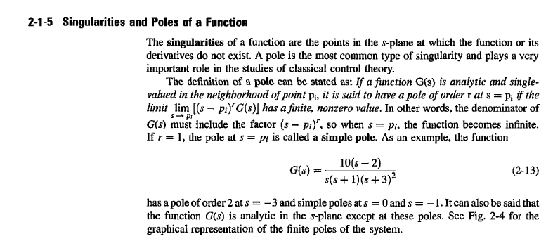

Hi, I try to learn the subject of automatic control and there is an explanation which I cannot understand, probably because of background of mathematics. Here is the explanation. I would like to ask that how a function be analitc in the s-plane and would you like to explain it.
Source: Automatic Control Systems by Kuo
Thank you

Here is an article on the properties of analytic functions:
https://en.wikipedia.org/wiki/Analytic_function
I think analytic would be opposed to not solvable analytically, i.e. numeric or stochastic methods were used to arrive at a solution.

In this context "analytic" means that it has a complex derivative in the complex plane, s. All polynomials are analytic in the entire complex plane and the quotient of polynomials is analytic everywhere in the complex plane except at the zeros of the denominator. So the function G(s) in the OP is analytic everywhere for s in the complex plane except at s = 0, -1, and -3.

The derivative of a complex-valued function, f, of a complex variable, z, at point z0 is the complex number d, such that d = limz->z0( f(z)-f(z0 ) / (z-z0). The limit value, d, must be the same no matter what direction z approaches z0 from.
When a function, f, has this property at each point in an area, the consequences are profound: If it has one derivative, then it also has all higher order derivatives. It has a convergent power series expansion. It's integral also has very special properties. I am sure that you will see a lot of this as you continue your studies.

Is this topic belong to Complex Analysis Theory? In which books and at which titles of those books I can find this topic? Even I do not know enough Real Analysis [Calculus], first should I learn Real Analysis?

Yes. It is complex analysis. Real analysis would emphasize things that will not help much. I would look for a book in control laws that will summarize the basic complex analysis that is needed to understand control laws. If you need more, you can just read sections of complex analysis books. And the complex analysis books should be for engineers, not mathematicians.
PS. If you mean calculus when you say "Real Analysis", you do need some understanding of introductory undergraduate calculus. A Real Analysis book is very different.
