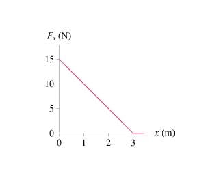

A 600 g particle moving along the x-axis experiences the force shown in the figure . The particle's velocity is 2.0 m/s at [tex]x = 0\:{\rm{ m}}[/tex].
Graph of force Fx in newtons against position x in metres: a straight line falls from 15 N at x = 0 to 0 N at x = 3 m, then stays at zero.
To be completely honest, I don't have a clue on how to even start this problem. I tried to use the 1D kinematic equations, but that didn't result in anything useful because I don't know the acceleration. I tried to find the acceleration with F=ma, but that still didn't make much sense. If I could get a nudge in the right direction, that would be awesome.
I know the answer is 6.8 m/s, but I do not know how to go about solving for that.
Hi tangibleLime! :smile:
Use work done = ∫ (force).(distance), and the work-energy theorem. :wink:
