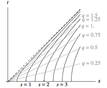

Incidentally, something is similarly true about the Rindler horizon seen by accelerating observers in flat spacetime; if I am an accelerating observer and I see you approaching my own Rindler horizon, I'll see you move slower and slower as you approach it and your redshift will approach infinity from my perspective, but you experience crossing this boundary (which is basically just the boundary of the future light cone of an event at the vertex of the "Rindler wedge", see the diagram here depicting the Rindler observers and the Rindler horizon from the perspective of an inertial coordinate system) in finite time and don't see me as infinitely blueshifted as you cross it.

Incidentally, did you look at the stuff on Rindler coordinates and the Rindler horizon in flat spacetime? From the perspective of an inertial frame, the Rindler horizon is a light-like worldline moving at c, and observers who are at rest in Rindler coordinates at positions closer and closer to the horizon will have greater and greater proper accelerations, so as seen in an inertial frame their velocities approach c more and more rapidly. See the diagram from this page, drawn from the perspective of an inertial frame, with the Rindler horizon as a dotted line and observers at rest in Rindler coordinates as black hyperbolas:
So, now consider an inertial observer who is momentarily at rest relative to one of these Rindler observers, i.e. an observer with a straight worldline whose slope is tangent to one of those hyperbolas at the moment it crosses it. You can see that if we consider the limit of hyperbolas closer and closer to the horizon, then in this limit the slope of the inertial observer whose worldline is tangent to a given hyperbola would approach the slope of a light ray, yes? And of course in the limit as your velocity in this inertial frame approaches c, the blueshift you will see from an observer approximately at rest in this frame (like a "far-field" hyperbola whose acceleration is negligible) approaches infinity too. But surely you wouldn't claim that this demonstrates that no object can actually cross the Rindler horizon, since the Rindler horizon is just an arbitrary light-like worldline in flat spacetime.

The light ray's worldline forms the "Rindler horizon" for that accelerating observer. If you imagine other light rays from events just to the right of the Rindler horizon (more straight lines at 45 degrees originating from events along the x-axis, slightly to the right of the origin where the x and t axes cross), then these light rays would catch up with the accelerating observer eventually. However, the closer the events that originated the light rays were to the Rindler horizon, the longer it would take for the light rays to reach the worldline of the accelerating observer--and since the accelerating observer's velocity is getting closer and closer to c, the longer it takes for light to catch up with him the more redshifted the light will be from his perspective when it reaches him. In fact, if you look at the limit as the events creating the light rays approach zero distance from the horizon, the redshift experienced by the accelerating observer approaches infinity. So in this sense we can say that the light from an event on the Rindler horizon would be infinitely redshifted, but that doesn't actually mean any "infinitely redshifted light" ever catches up with the accelerating observer, you can see from the diagram that a light ray traveling along the Rindler horizon just never reaches the observer. On the other hand, a normal observer crossing the horizon wouldn't see a light ray traveling along the horizon as infinitely redshifted, since this observer would have some finite velocity smaller than c as he crossed the horizon. The increasing redshift from events closer to the horizon experienced by the accelerating observer is not an intrinsic property of the light from those events, it has to do with the fact that the closer the event is to the horizon, the higher along the t-axis you have to go before the light from that event intersects the worldline of the accelerating observer, and the higher you go along the t-axis the closer the accelerating observer's own velocity is to c.
And if you look at the Kruskal-Szekeres diagram it works exactly the same way--the event horizon is a straight line at 45 degrees, and the worldline of an observer hovering at constant Schwarzschild radius is a hyperbola which never touches the event horizon, and all light rays are also straight lines at 45 degrees. So it's for similar reasons that light from events closer and closer to the horizon will be increasingly redshifted as seen by the constant-Schwarzschild-radius observer, and "infinite redshift at the horizon" is just a statement about limits, a light ray from an event actually at the horizon will just never reach this observer, but an infalling observer who does cross the horizon will see this light as having a finite redshift.
The point is, you can't really reject statements about "infinite redshift" in the case of the black hole without also rejecting these statements in the case of the Rindler observer and the Rindler horizon. But as long as you understand that these are just statements about limits, and that there is never a situation where a light ray actually hitting a given observer can be said to have infinite redshift by that observer, then you should be able to see why there isn't really anything unphysical going on here.

Note that exactly the same is true of the Rindler horizon in the non-inertial Rindler coordinate system--it is at rest in these coordinates, but relative to any inertial frame in SR, the Rindler horizon is moving at c, as you can see from the diagram in my earlier post which was drawn from the perspective of an inertial frame.

Sure--any light ray in SR would be the Rindler horizon of some Rindler coordinate system, and it would always be possible to have an observer with constant proper acceleration who has this light ray as his own Rindler horizon (meaning the light ray gets arbitrarily close to him but never quite catches up as long as he maintains the same acceleration). So anytime a slower-than-light object crosses the path of a light ray anywhere in spacetime, it has crossed beyond a Rindler horizon.

Again, you can put yourself on the other side of your Rindler horizon just be stopping your acceleration. The Rindler horizon is something seen in special relativity, where gravity isn't taken into account, so it has nothing to do with black holes.
