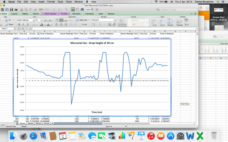

This discussion focuses on calculating the energy absorbed by a football shin guard during impact testing. Participants emphasize the importance of measuring the change in kinetic energy, which can be determined by analyzing the velocity of the impacting object before and after the collision. The conversation highlights the use of drop tests and pendulum apparatuses for accurate measurements, as well as the need to account for energy loss due to the coefficient of restitution being less than one. Additionally, the discussion touches on the significance of recording acceleration versus time to derive energy loss calculations.
