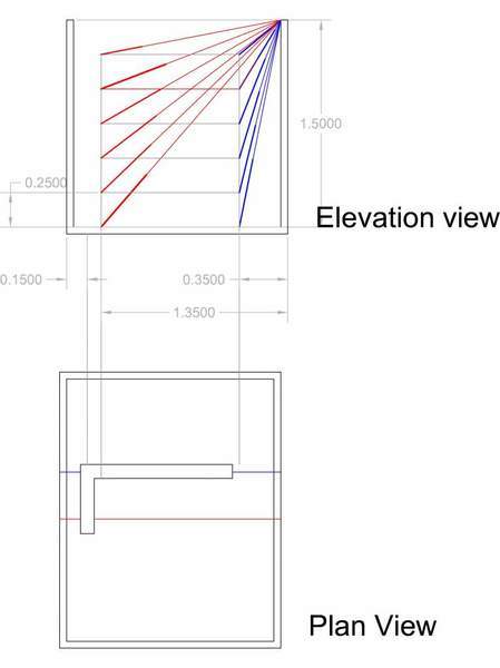

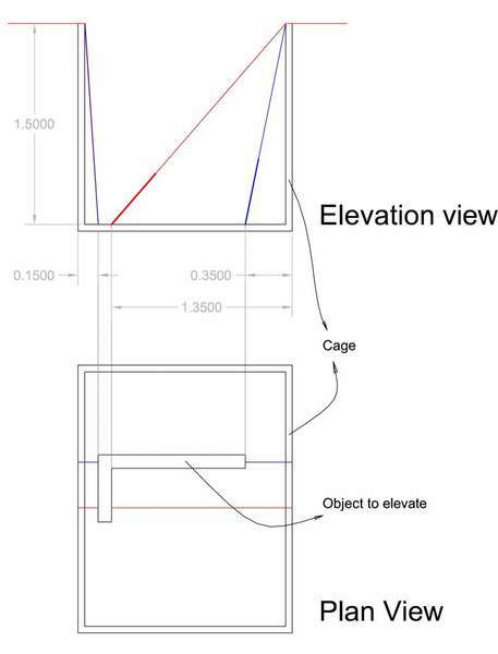

I am trying to create a mechanism that will elevate an object evenly. I have built (this is a real life case) a "cage" which is 2m x 1.5m by 1.5m tall and in the cage there will be placed an object with a geometry similar to the one in the drawing attached.
I have thought of rising the object by placing two ropes under it and bringing the ropes over the side of the cage and pulling from there. However because of the geometry of the object when you pull the same amount from both ropes, the object doesn't rise evenly.
So far I have obtained an equation that relates the relation between what the blue rope rises and what the red rope rises as a funtion of the height the object has risen (this relation changes with the height). I don't know how to obtain it formally, so what I did is draw the object (in Autocad) at 0.25 intervals, then I drew a 0.5m pull from each rope, obtained the relation between what each rope rises at each interval, and then solved a system of equations. My results were:0.589x^3+2.711x^2+4.526x+3.974 with the origin set at the top right end of the cage and "y" positive upwards. However I have no idea of mechanical engineering nor how to design a mechanism that will elevate the object evenly. I'm thinking that maybe will pulleys, but I really don't know... Please help.
Thanks!

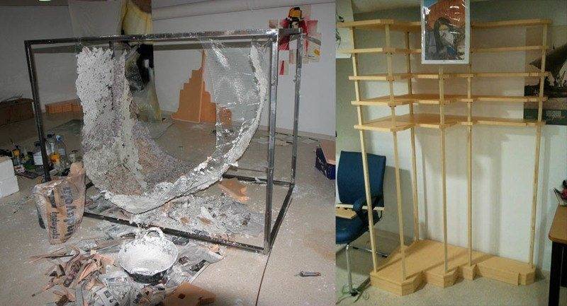

I have attached a image of what I have so far. Maybe the photos don't give a sense of scale, but it's quite big. The tower (the image on the right) would go on top of the cage (the platform of which it would rest hasn't been built yet). Thanks

To clarify things, attached is a graph which shows the relation between what the blue rope rises and what the red rope rises, as a function of the height the object has risen. The origin is at the upper right side of the cage. Note that when the object is at -0.4m, you have to pull 3 times more from the red rope than from the blue one.

Ok some context: I'm an architecture student, and the model is part of an assignment which we have to hand in at the end of May. We are working as a group of three people.
So, because we are students and it's our money we are investing in the model, we aim to spend as little as possible.
At the moment, we are working in a basement, but the model has to be showcased once a month in class. Hence, the model has to be dismountable and transportable.
And we have no means of our own, or means which can be lent to us to lift the tower at the moment (hydraulic cylinders, screws, cranes, forklift...). The most we could manage is ladders, ropes, our hands...
Oh and the tower is extremely fragile. It consists of wood columns and styrodur slabs which aren't fixed to the columns, they just sit on them.
Can you place the irregular base of your tower on a flat, rectangular base plate? Then you could simply use ropes attached to the corners of the rectangular base plate and suddenly the geometry is simple again.
Well, in reality there is going to be a big void at the top of the cage and the cage is only going to be covered at the part where the tower rest. However it could be a compromise solution, lifting it with a symmetrical board, and then sliding it to its definitive stand. In the end it may be simpler than figuring out how a pulley mechanism would work in an asymmetrical rig.
