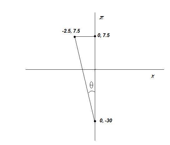

Hi,
I tried the same problem but slightly different way, without involving any equation but doing it geometrically.
Pa and Pb are the two points of a line in 3D, just project this line on -XZ (negative X and Positive Z) axis, the point Pa will have x intercept 0 and Z intercept -30, like way Pb will have -X = 2.5 and Z=7.5. Now this forms a triangle with angle Θ with the Z axis as shown in the picture.
tan Θ = 2.5/37.5 = x/60
x is the x intercept of the line at Z=30
solving this simple equation we can get x, in the same way we can proceed for y.
But this method works easy for this given problem, it might be tedious for higher complex problem...
  • Diagram of a line in the x-z plane with a horizontal x axis and vertical z axis; a point at (0, 7.5) on the z axis, a point at (-2.5, 7.5) to its left, and a point at (0, -30) below the origin, joined by a line with angle theta marked against the z axis.
