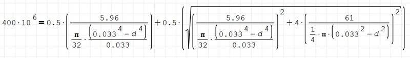

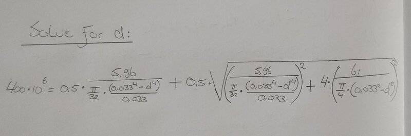

I would like to solve the equation for "d".
Dear mathematicians,
I am getting stuck solving this equation for "d". And what (free)software would you recommend to check this equation?
Thanks a lot!
Mech_LS24 said:
Summary: I would like to solve the equation for "d".
Thanks a lot!
Unless something cancels it's going to be a 10th order polynomial. And given your numbers it's highly unlikely to be factorable. W|A, Mathematica, or Matlab would be my suggestions.
-Dan
If you really want to attack that expression, I recommend the substitutions ##x=0.033^2 -d^2 ## and ##y=0.033^2+d^2##. And you should consider using a Weierstraß substitution!
