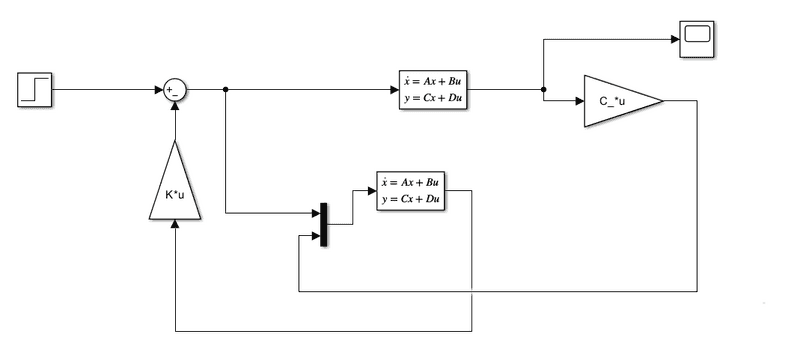

and I connect it to this model :

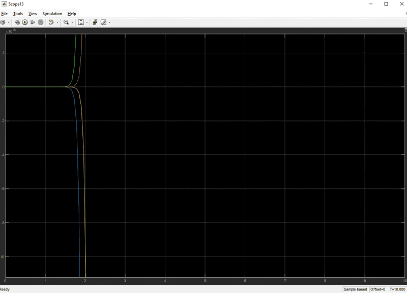

but somehow I am only able to produce this result :
Do you know what is actually wrong with my code?? any response and help is really appreciated..thanks before
