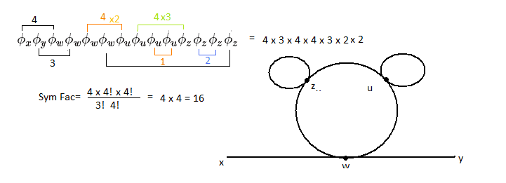

Can someone check the symmetry factor I've found in the following diagram and verify it?
Do you know if there is any way to determine the SF of a diagram fast?
So I have [itex]\phi_x[/itex] which can be contracted with 4 [itex]\phi_w[/itex] : 4
Then [itex]\phi_y[/itex] which can be contracted with 3 [itex]\phi_w[/itex] : 3
Then I have 2 [itex]\phi_w[/itex] which can be contracted with 4 [itex]\phi_u[/itex]: 2x4
Then I have 3 [itex]\phi_u[/itex] which can be contracted with 4 [itex]\phi_z[/itex]: 3x4
The rest [itex]\phi_u[/itex] get contracted together (only 2 left), whereas the [itex]\phi_z[/itex] we get a factor of 2 since there are 2 possibilities to contract 3 fields.
Finally the last contraction gives just a factor 1 (no possible alternative choices).
So the result from contractions is 4x3x2 x4 x3 x2 x 4 = 4! x 4! x 4
The diagram is of order 3 (3 vertices) so there is a factor 1/3! and also the 1/4! from the coupling constant for [itex]\phi^4[/itex] theory.
So is it correct to say that the symmetry factor is afterall SF=16?

Your factor of 2 (in blue) should be 3. From three fields, there are three possible distinct pairs to construct (AB, AC and BC).
But there is also a second point: there should be a factor of 1/4! for each vertex, so you should have 1/(4!)^3 instead of 1/4!
As for a shortcut: usually people drop the denominator and simply calculate the symmetry factor of the graph (the number of automorphisms in mathspeak). I think there is a nice discussion in Peskin and Schroeder if I recall correctly.
In Peskin they say that they drop the 1/4! factor and write the vertex factor as [itex]\int d^4 z (-i \lambda)[/itex] because they say that to a generic vertex has four lines coming in from four different places so the various contractions of [itex]\phi \phi \phi \phi[/itex] is 4!...Also the n! from the Taylor expansion will cancel because of interchanging of vertices...
But I don't understand either of these explanations...
So in case I used (1/4!)3 I would have obtained the correct result?
[itex]A= \frac{16}{4! 4!}= \frac{1}{3! 3!} = \frac{1}{36}[/itex]
So the symmetry factor is: 36?
