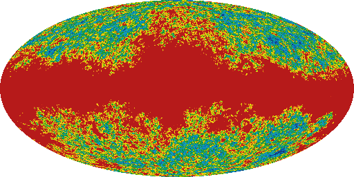

DevilsAvocado said:
If we look at the video at around 3:30 we see the CMB as a sphere surrounding the very distant supernovas and distant galaxies, and finally the Earth:
Now, my question is:
We cannot see the light from distant galaxies and supernovas and at the same time see the CMB from these objects/regions, right? These CMB photons must have passed us a long time ago, right?
If this is correct – shouldn’t there be a minor 'gap' in the CMB somewhere (in Ned Wright’s picture e.g.)...?
(Maybe a stupid question...? :rolleyes:)
Given the content of your post that you quoted, let me just state that yes, when we take measurements of the CMB, a major part of the effort of determining what the CMB says about cosmology involves determining how much of the light we observe came from the CMB and how much came from stuff between us and the CMB. This problem is, fundamentally, why WMAP measures the CMB in 5 different frequency bands, and why Planck is measuring it in 9 different bands.

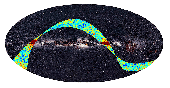

Very interesting. I discussed this topic with Wallace (in the same thread) and came to the conclusion that the Milky Way is the biggest 'problem':
Is there a webpage on Planck yet (pictures/info)? When is the results expected?
For now, the only public data from Planck is from the First Light Survey:
http://www.esa.int/esaCP/SEM5CMFWNZF_index_0.html
No science results have been released as yet, but the plan is to put the first set of science papers out one year after the first year of observation is finished. So that would be around August-September 2011. I am curious to see whether or not the Planck science team will decide to present some preliminary results earlier, however, such as some early maps (our first survey of the whole sky will be finished in about 3 weeks). I suspect not, as there is a lot of work that needs doing before we're confident enough to really use our results for science.
Wow! What a resolution!
This will be like waiting for Santa Claus10! :smile:

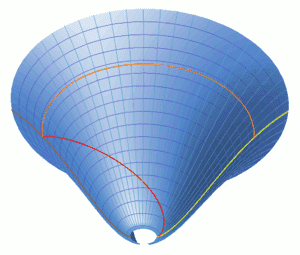

Pictures have always helped me to understand this complex matter, and I think you could use the picture below to understand how a light ray (red line) can travel an effective distance of 28 billion light years (orange line) in just 13 billion years. This also reveals the fact that observable universe = calculated visible universe.
For more info, read http://en.wikipedia.org/wiki/Expanding_universe#Understanding_the_expansion_of_space" on Wikipedia.
Another good example is this one, from http://www.astro.ucla.edu/~wright/photons_outrun.html" .
The animation shows the expansion of space and the evolution of the galaxy density, positions and the photon positions within a '78 billion light year box'. Each black dot represents a galaxy, and the two green dots are galaxies emitting red photons.
A photon does not know how fast its emitter was receeding when it was emitted. It also does not know how rapidly the volume of space it is traveling through is expanding. Were this not true, it would be difficult to explain how cmb photons manage to reach us.
