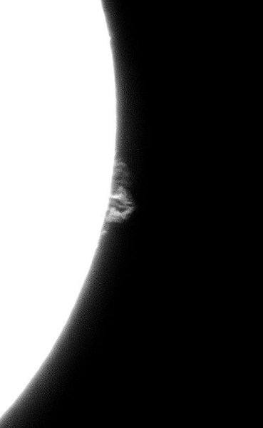

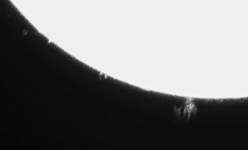

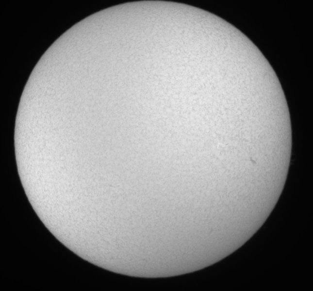

  • #66

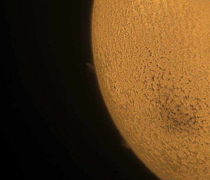

hi guys and gals
OK finally starting to figure out how to use all this new software and hardware for viewing and imaging the sun
finally a first decent image of a prominence today 2017/11/14
gear - Lunt LS60THa solar telescope, ZWO178MC camera and SharpCap software
trying to image in daytime is a real challenge ... dealing with daytime glare on a laptop screen
this is a single image capture
Dave

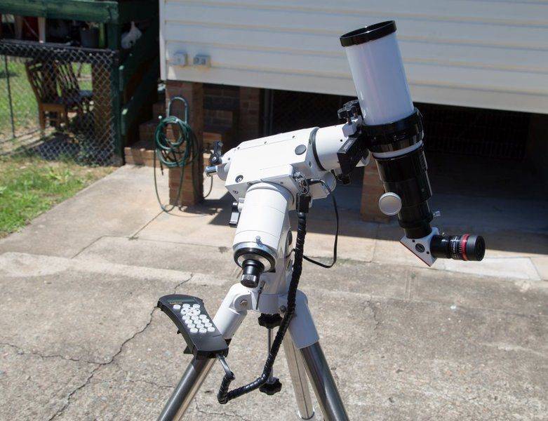

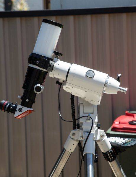

  • #67

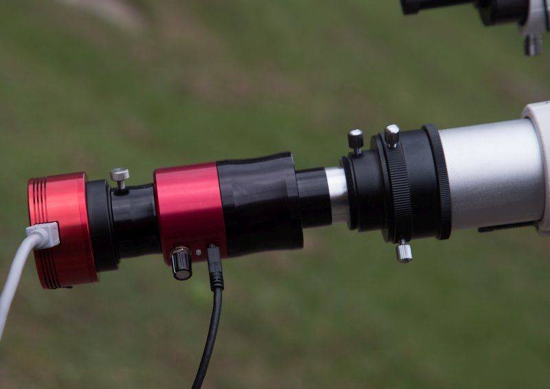

just a quick pic of the setup, the laptop inside cardboard box for some shielding of the screen from the sunlightI needed to stick my head into the box up close to the screen to stop the sunlight reflections off me getting onto the screen ...

  • #68
Lovely image, Dave.
The hi-tek box and wheelie bin are very impressive too.
  • #69
"necessity is the mother of invention" ... so I am told :smile:
it was suggested elsewhere that ...
1) I paint the inside of the box matt black and
2) I use a dark cloth shroud over the box and my head to further darked things ... think of photographers of old :smile:Dave
  • #70
You could buy a 'toilet tent' as a form of observatory and work the whole think from inside. The scope could poke through a flap. If you cut the bottom off the fabric, you would get good air circulation. These things are available in UK for very low prices so they should be cheap anywhere in the world and you wouldn't need guy it.
PS Don't expect sympathy from a heavily autumnal UK, for having a lot of Sun.

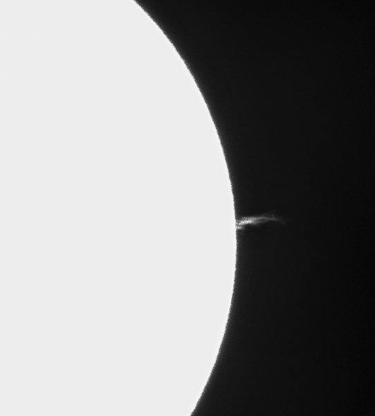

  • #71

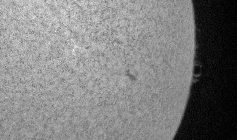

Solar activity -- 20 Nov. 2017
a quick shot of the prominence and long winding filament on today's sun
this is just a single frame

  • #72
Smashing picture Dave.
Your cost per recorded pixel is dropping fast! :wink:
  • #73
thanks buddy :smile:ahhh yes it is :biggrin:
one of the next steps is to figure out using the software to load in a short .avi video file
and it extracts the individual frames and stacks them. When I get to do this, we should see a big
improvement in image quality
At this time just getting used to using the scope, astro camera and software to capture single images
today's image isn't as sharp as the last one, by the time I got home from work today ~ 5pm, the sun
was getting low in the west and the light coming through much more atmosphere causing the usual instabilityDave

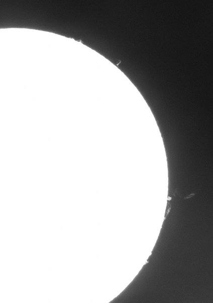

  • #75

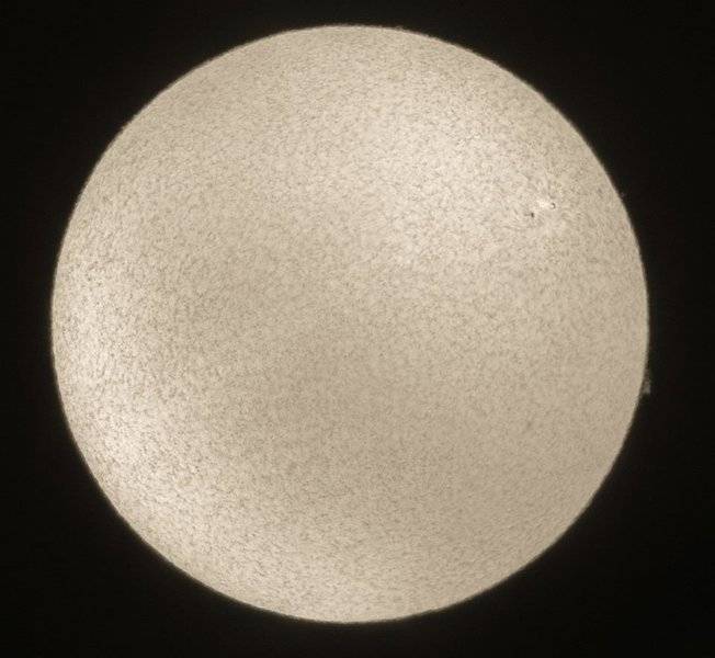

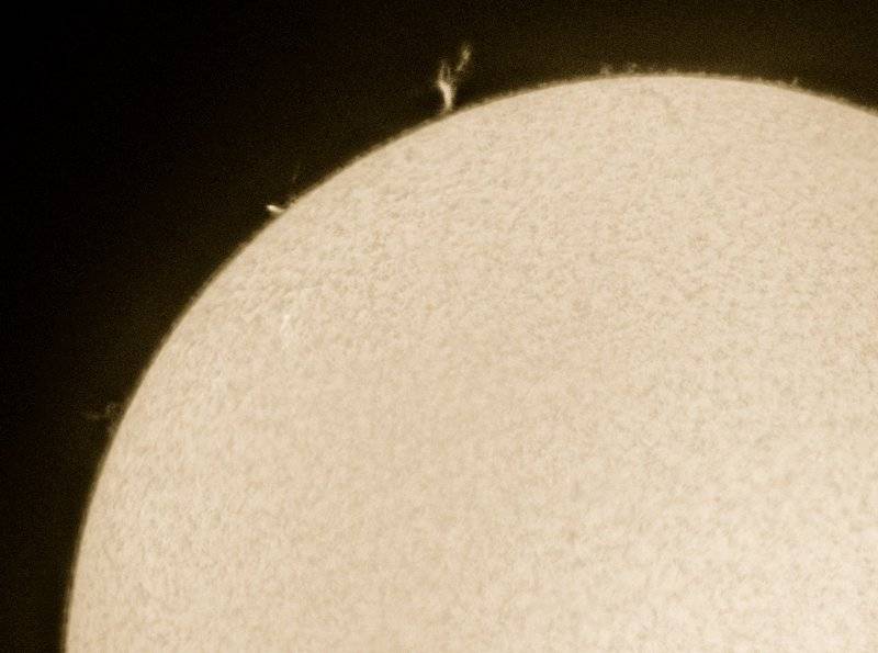

The Sun, 22/11/2017, about the best image so far
Reasonably good seeing conditions today
quite pleased with the result
Still pretty good and interesting. The previous one was kind of too bright I think. Is that the normal?
  • #77
the centre is always going to be brighter than around the limb.
it's tricky ... bringing up the brightness so the prominences can be seen well and the face is way too bright
lower the brightness so the face is well exposed and the limb prominences fade away
this image is a trade off between the 2 extremes
  • #78
What's the best time of the day (regular normal day/conditions) to naturally fall in between, if possible?
  • #79
when the object of interest is high in the sky ... sun moon, planets, deep space object
that is when you are viewing/imaging through the least amount of atmosphere, the lower you go towards the horizon, the thicker the layer of
atmosphere you are viewing through and hence more instability
the image in post #71 was late in afternoon, around 5:30 - 6pm and the sun was getting pretty low
hence the quality was not good.
Today's image was at 430pm still getting a bit low but not as bad, so the stability was much betterDave

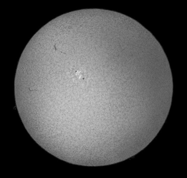

  • #83

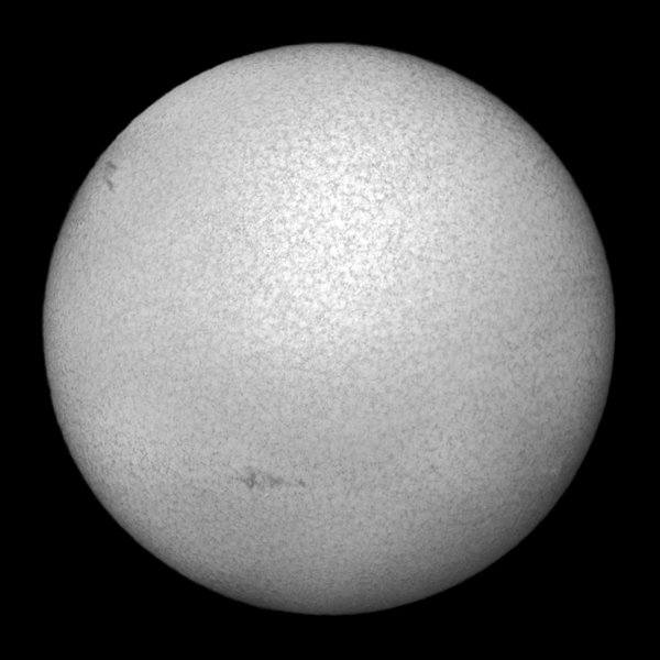

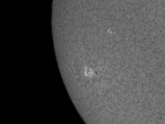

The Sun 24 Nov 2017
trying a B&W version instead of colour ... sort of have the feeling it gives better contrast of the visible structure ?
A reasonable prominence upper left, a sprinkling of smaller ones elsewhere
some small filaments here and there but the major feature is the long lasting filamentDave
PS ... Just to clarify ... I didn't image this in B&W ( greyscale) It was imaged in colour and then fully desaturated in Lightroom whilst doing the other processing edits

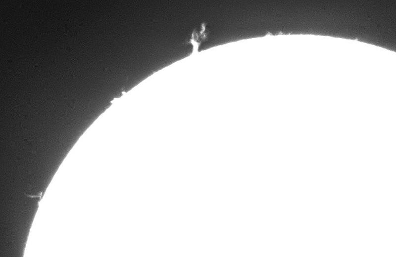

  • #84

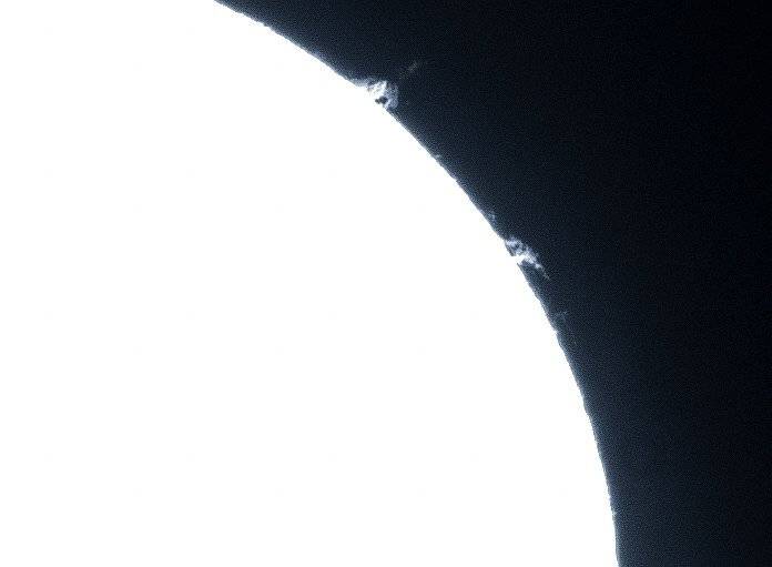

The Sun 10 Dec 2017, 05:10 UT
Several really nice prominences on the sun today ... was first chance to do imaging in over 2 weeks ...
Has been a mix of nothing much to image and when there was, it was cloudy for me
But finally a clear sky and good prom's
During the 30 mins I was observing/imaging, that smaller upper right one disappeared
and the lower left one, I could see changes as material was falling back towards the sun's limb

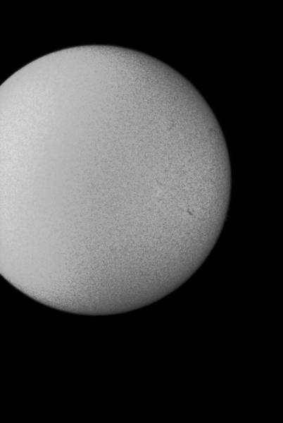

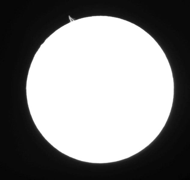

full disk image from the 10 Dec
