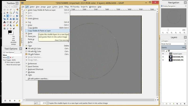

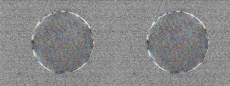

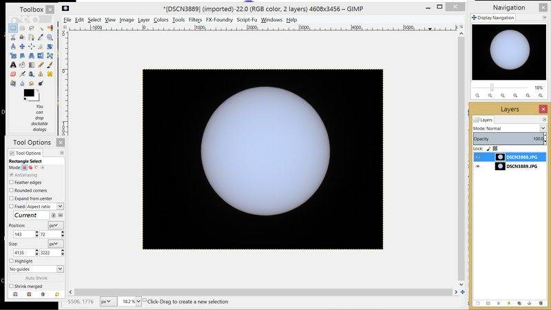

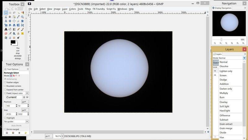

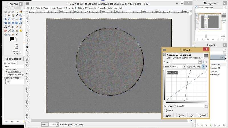

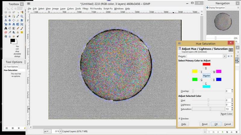

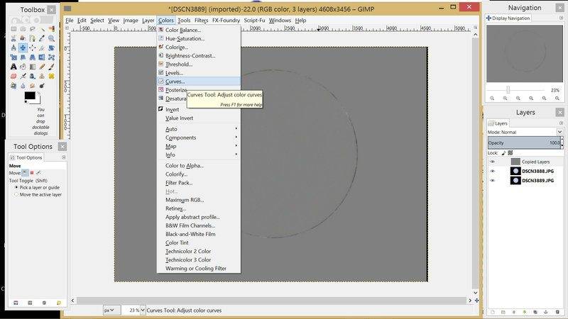

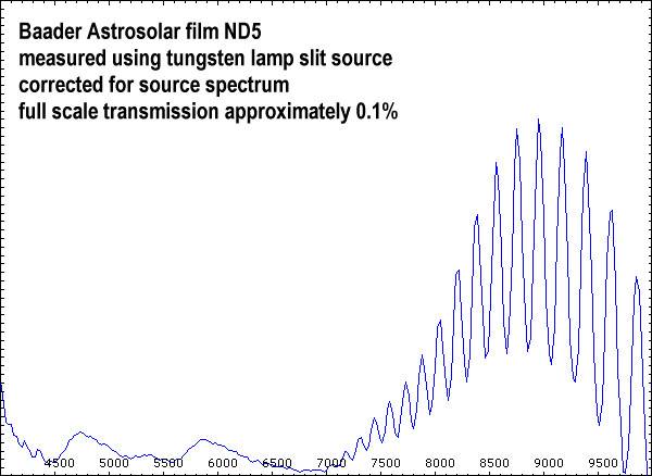

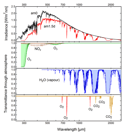

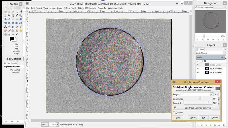

I am using a Nikon P900 with a Baader 5.0 filter on a regular camera tripod. Usually shoot at maximum optical, 83x, sports mode for a burst of 7 in 1 second. Greater than a minute between shots, it starts to noticeably blur the final image.
I'll post some images to walk through the process.
The spectral response of Baader in the NIR and into the IR appears like an etalon comb response, it is a multilayer metallic sandwich - so maybe. My IR blocking filter extinguishes completely at ~ 750nm, so there are only a few candidates for the NIR terrestrial spectrum making it to my camera.
'Grain extract' subtracts two images and adds 128. Differences between my images are caused by many things, image stabilization being the most consistent for sub-pixel offsets, then there is my inherent alignment error between the stacks.
I have spent a few months comparing the SDO and SOHO images to the Baader/differencing technique - I am posting this because the correlations are significant. The thermal envelopes and shock waves are almost like a ghost of the UV activity seen in SDO.
Working on OpenCV for real time video processing with this technique, will move the design over to an FPGA next month to get the frame rates up.

@Zeke_D Thanks for that. So you seem to be basically temporal high pass filtering (plus some DC offset) and that removes most of the energy - explaining the high noise, I guess. I would imagine that processing a long sequence of movie frames could allow you to dredge more patterns up from the noise with long sequences of frames (less than one minute, from your comment about gap between frames.)
It's encouraging to see that worthwhile information can be obtained about the Sun without having to spend vast sums on filters.

Even with your walk-through of your processing, I have to admit, I'm still not totally sure of what I am looking at … detail wise ??
Continue to post and keep up the explanations :smile:regards

Yes. There is just one image where there is a clear area, to the right of the Sun where 'something is going on' but I think we need some help to make more sense of some of the images in post #152.
