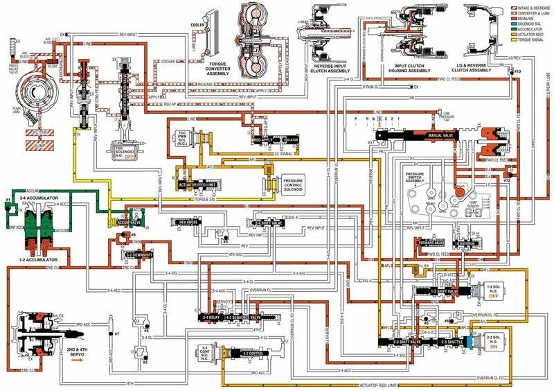

Switches ... It's all about switches.
As soon as you turn the computer on, the current goes through pre-defined circuits and ends up doing an action. With additional software, you are setting the switches differently to "customize" the output.
The mechanical equivalent would be the valve body of an automatic transmission, which is really a very simple hydraulic computer.

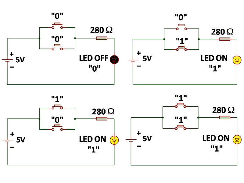

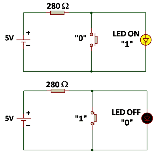

But logic gates are really just a bunch of switches:
LOGIC GATES USING SWITCH
AND GATE USING SWITCH
OR GATE USING SWITCH
NOT GATE USING SWITCH

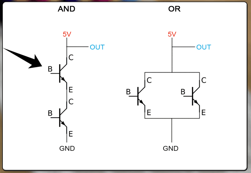

And when done with transistors, it looks like this:
