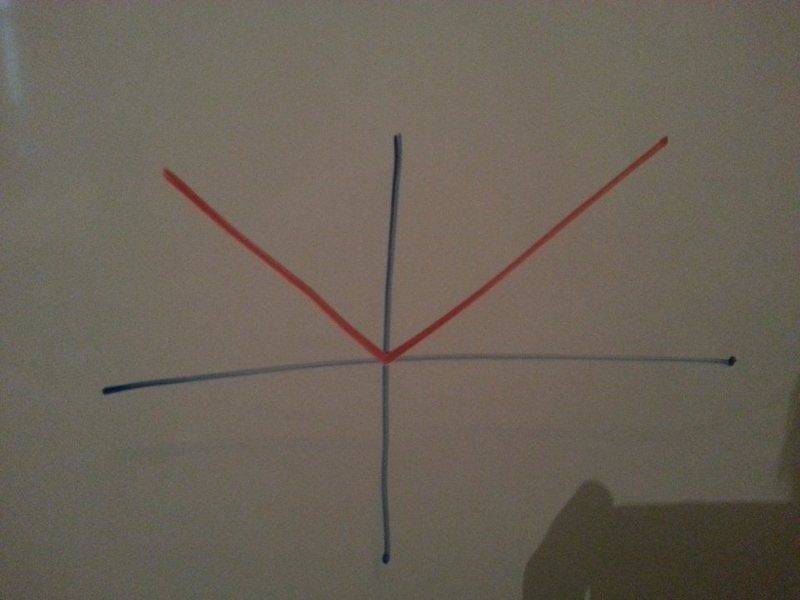

Transform the coordinates from the red c-system to the blue system. (Picture)
Using(X Y) for the red cartesian system and (x y) for the blue system
The solution to this problem gives
x=Xcos▼ + Ysin▼
y=-Xsin▼+Ycos▼
Im not sure i understand in what way was this transformed. How can x coordinate in blue system contain Y coordinate from red system? [/B]

It doesn't look like the coordinates were translated between the two systems.
What other manner of transformation is suggested by the diagram?

Looking at the diagram, it looks like
##(1,0)_{(X,Y)} = (\cos \theta, \sin \theta)_{(x,y)} ##
and
## (0,1)_{(X,Y)}=(- \cos \theta, \sin \theta)_{(x,y)}##
Indicating that the angle from the x - axis is the same for each of the red basis vectors.
Or is it that the red axes are orthogonal? In which case
##(1,0)_{(X,Y) }= (\cos \theta, \sin \theta)_{(x,y)} ##
and
## (0,1)_{(X,Y)}=(\sin \theta, - \cos \theta)_{(x,y)}##
I think that the above equations correctly describe the transformation even if the red coordinate system is rotating, taking your example of (0,1) and putting the angle equal to end points of 0,pi/2,p we get the correct trabsformation. It agrees with the book answer, it goes with the proposed experiment so i think its right. Do you agree?

My question was if the red coordinate system was based on orthogonal vectors.
I did not think that the angle was a variable in the red system, is this some sort of polar coordinate system? I see the blue system as having the standard ##\hat i, \hat j## orthonormal basis vectors.
If the red coordinate system has orthonormal basis vectors ##\hat e_1, \hat e_2## such that any point in the plane may be expressed as ##X\hat e_1 +Y \hat e_2## you are looking for a way to transform coordinates given as ##(X,Y)_{(red)}## into ##(x,y)_{(blue)}##
The easiest way to do a coordinate transformation is to see what happens to the basis vectors themselves.
Assuming that ##\hat e_1## is the vector pointing at about 45 degrees off the x axis, then ##(1,0)_{(red)}## would translate to ##(\cos \theta, \sin \theta)_{(blue)}##.
Assuming that ##\hat e_2 ## is the vector pointing at about 135 degrees off the x-axis and orthogonal to ##\hat e_1##, then ##(0,1)_{(red)}## would translate to ##(-\sin \theta, \cos \theta)_{(blue)}##.
You can build the transformation matrix by stacking the transformations of the basis vectors like this:
##[T] = \begin{pmatrix} [Te_1]^T & [Te_2]^T \end{pmatrix} ##
Which would look like:
##[T]_{red \to blue} = \begin{pmatrix} \cos \theta & -\sin \theta \\ \sin \theta & \cos \theta \end{pmatrix}##
Then your transformation would be a matrix multiplication of
## \begin{pmatrix} x\\y \end{pmatrix}_{(blue)} = [T] \begin{pmatrix} X\\Y \end{pmatrix}_{(red)}.##

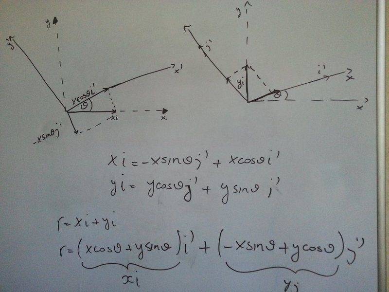

In fact i have a scatch done last year by my friend which solves the problem. I added it below. Can you see where our mistreat was?
Here it is.

There are two slightly different versions of such transformations.
Say you have on original coordinate system and a point ##p = (x,y)## in it. Then you can do two things:
(1) fix the point in place but rotate the coordinate system counterclockwise through the angle ##\theta## (which is actually clockwise if ##\theta < 0##). In this case the same physical point ##p## has new components ##(x',y')## in the new coordinate system.
(2) Fix the coordinate system but physically rotate the point ##p## clockwise through angle ##\theta##, to get a new point ##p' = (x',y')##.
One of these scenarios will have
[tex]x' = x \cos \theta - y \sin \theta\\<br /> y' = x \sin \theta + y \cos \theta[/tex]
while the other one will have
[tex]x' = x \cos \theta + y \sin \theta\\<br /> y' = - x \sin \theta + y \cos \theta[/tex]
I will leave it to you to figure out which is which.
Based on this picture it seems like the equations presented on the blackboard depict a point rotation rather than whole syatem, is it not?
I see now. I was simply translating (X , Y) in the red coodinates to an (x, y) in the blue coordinates. Where (x , y) and (X, Y) refer to the same location.

So thos refers to rotation of the point as well as the system and the connection to the old system and the ones given by the whiteboard rotate the system but keep the point fixed, is it so?
