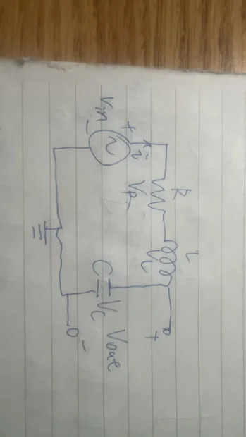

Hi, I am trying to build a RLC low pass filter that atenuates the frequency below 4500 Hz. However, I have encountered some problem when choosing the correct R to work with.
Here is the Circuit
Here is the original sound.
Here is my code in Matlab
function Vout = myFilterCircuit(Vin,h)
n_V = length(Vin);
f_7 = 4470;; % Undesired frequency
h_7 = h; % delta time
% These are for the constant and initialization of the variables
t_7 = 0:h_7:(n_V-1)*h_7; % This is the independent variable
LC_2 = 1/((f_7*2*pi)^2);% This is for L C
R_7 = 0.0001; % This is R
L_7 = 1*10^-3; % This is L
C_7 = LC_2/L_7; % This is C
A_2 = [1,h_7/C_7;-h_7/L_7,1-h_7*R_7/L_7]; % This is the A matrix
B_2 = [0;h_7/L_7]; % This is the B matrix
C_2 = [1,0]; % This is the C matrix
D_2 = [0]; % This is the D matrix
sys_8 = ss(A_2,B_2,C_2,D_2,h_6); % This is the system
[y_8,tout_8,x_8] = lsim(sys_8, V_inter, t_7); % Simulate the system response
Vout = y_8(:,1); % This is the V_c output.
figure;
bode(sys_7, sys_8);
legend('60Hz LPF', '4470Hz LPF');
end
Here is the Bode Diagram
So you can see I used the inductance of 1*10^-3, and capacitance around 1.26*10^-6. I try to use the resistance of 0.0001, but it does not work. And the system of equation eventually becomes not solvable. Please let me know what value of R I should choose.

Hi,
Interesting exercise. Your post is rather incomplete though, and also hard to follow.

I only have Octave instead of matlab, but it tells me I need to run pkg load control to use the ss function.
Furthermore, your code only shows a function, not what is calling the function. So Vin and h are unknown; further down h_6 is unknown and so is V_inter.
I personally have no idea what matrices A, B, C, D represent, but that may be just ignorance.
Do you mean "attenuates frequencies above 4500 Hz" ? What about the 60 Hz ?
R = 0.0001 is unrealistically low.
Can you explain what the variables in your relevant equations are ?
My bad, it should be keep the frequency lower than 4500 Hz and Atenuates the frequency above 4500 Hz.
The 60 Hz should be reduced by a RLC bandpass filter.
A, B, C D are just the matrix representation of the set of differential equations.
you can see my note here
I guess just generally what is the factor that determines how quickly the amplitude decays for the low pass filter.
The resistance (the losses) in the circuit control the filter response at/near resonance. EEs call this Q, others use damping. I wouldn't ask your code to choose this, it's easy enough with simple formulas to do it based on what you want your filter response (bode plot, etc.) to look like. That way you'll be more likely to understand and remember it.
Yes, we could just tell you the answer, but that's not how we roll here. Study some of my comments on the web a bit first. I like Khan Academy for most things like this. Then ask us about the parts that you don't understand.
BTW, I know this seems like just a HW problem, but this is a really, really, important thing for anyone in the physical sciences to understand. It is a version of the simple harmonic oscillator which is crucial for damn near every subject, from race car suspensions, antennas, power supplies, up through quantum mechanics. You WILL learn it at some point, you'll have to.
PS: Maybe start with a search for "second order filter Q".
Can you write a simple equation for ##{V_{out}(\omega)}## / ##{V_{in}(\omega)}## using complex impedance values (phasors, et. al.)? Have you studied that yet? Hint: it's a voltage divider.
