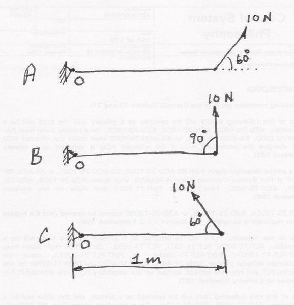

That is correct, but I was asking about the direction of the force at that point. For example, in this drawing, which direction of the 10N force (A, B, or C) produces the maximum moment at point O?:
Three hand-drawn diagrams labeled A, B and C, each showing a horizontal rod pivoted at point O with a 10 N force arrow applied at its far end. In A the force is at 60 degrees above the horizontal. In B the force is vertical at 90 degrees. In C the force points up and to the left at 60 degrees. Diagram C has a 1 m length marked below it.
insightful said:
That is correct, but I was asking about the direction of the force at that point. For example, in this drawing, which direction of the 10N force (A, B, or C) produces the maximum moment at point O?:View attachment 90160
B
werson tan said:
B
Correct! So, what angle to any moment arm would give the minimum force to produce a given moment?
