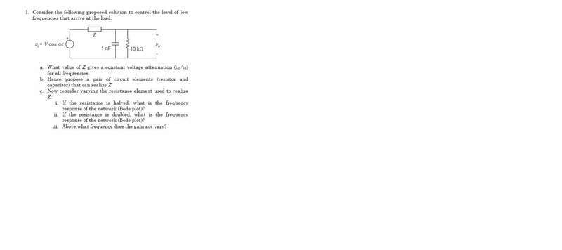

Exams are coming up and I've been doing some revision from past papers. Having issues with working out part c of the attached problem. I've already calculated part a and b, possibly correct. Basically I simplified resistances and capacitance. And to have a constant frequency I let Z equal the inverse of the simplified resistance to cancel ω the frequency component. I then used this information to determine a new resistance and capacitance that had no ω component.
Any hints or tips would be greatly appreciated.

If you did parts a and b correctly (they're really the same question) then you got R1C1 = R2C2 where 1/Z = G1 + sC1, G1 = 1/R1, and R2 = 1/G2 = 10K and C2 = 1 nF.
Now R1 → 2R1 so what is your new transfer function? And same question when R1 → R1/2. Do you know how to draw Bode plots?
Part 1 c iii does not specify the circuit so can't be answered.
Not sure exactly what you meant by your answer to the first two parts.. However the way i calculated it was by simplifying the resistor and capacitor in parallel. This gave me 1x10^4 + 1x10^6/jw. Then I assumed that to remove jw, since Z is now in series with this equivalent resistance, it would have to equal -1x10^6/jw.
For part b. I assumed a resistor of 1Ω in parallel with a capacitor of 0.1x10^-6. Simplifying this to obtain 1x10^6/jw + 1. I assume this answer would be negative as that's how it would cancel if it was added in series. This is the new realized Z which then adds to the result of the previous question which gave a result of 9999Ω. Which has no ω component.
Is this the correct approach?
What do you mean by 'simplifying'? Do you mean determining the combined impedance of the 10K resistor and 1 nF capacitor in parallel? If so, you did that wrong. Y = G + jwC so Z = 1/Y where G = 1/R. The real part of the complex impedance of the 10K and 1 nF is frequency-dependent.
BTW 1 nF = 10^(-9)F, not 10^(-6).
So you don't have the correct network for frequency-independent gain yet.
In this situation I know from experience that it's much easier to deal in admittance Y, conductance G and susceptance B than impedance Z, resistance R and reactance X. The relations are simple: Y = 1/Z, B = 1/X and G = 1/R. Example: for a capacitor, B = wC and Y = jB.
You'll recall that for parallel-connected components, susceptances are added: so for your R and C, Y = G + jB = G + jwC, G = 1/R.
Given the above, what is Vout/Vin of your diagram if we replace Z with Y = 1/Z?

Just to get me back on track, Z is meant to equal Z0 which is: 1/(1x10^(-9)jw + 1/10000)?
I just used the relationships you were describing to find: Y = 1 x 10^(-9)jw + 1/10000
Then to find Impedance: Z = 1/Y, therefore Z = 1/(1x10^(-9)jw + 1/10000)
Is this correct so far?

Fine so far! But forget Z of your network. You'll be dealing with Y's instead.
Also, don't put in numbers yet. Call the 1 nF = C2 and the 10K = R2 = 1/G2.
Now, what is Vout/Vin in terms of this Y2 = G2 + jwC2 and the Y equivalent of the Z as marked on your diagram? Defie Y1 = 1/Z.
