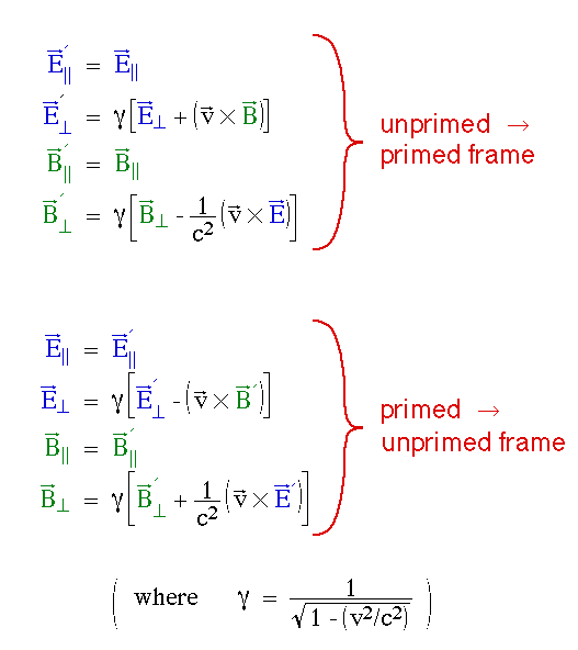

U have made a slight mistake in the formula, the electric and magnetic field terms do not have same units so, a factor of velocity should be multiplied to the B in the equation(v/c is dimensionless). But u have made a remarkable attempt to solve the problem. Could u please solve the problem with corrected equation and show that force is same in both frame A & B.
Nonsense, the formulas are correct. They're in Gaussian units.
I have attached image for the correct equation of transformation. Ur formula is wrong even in gaussian unit.
lovetruth said:
As far as i kno, only length, time, mass, and energy transforms. Please give me the list of all the entity that can transform.
Everything transforms! The question is only how it transforms.
