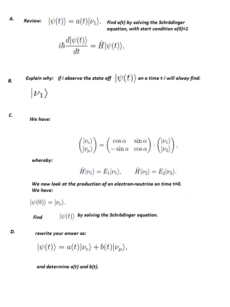

Hey,
I'm a high school student from Europe and my final paper is on Neutrino oscillations.
I practiced some basic quantum states(qbit), but i find it much harder for this neutrino problem.
I translated it in hope that some of you could give me some pointers. I left some parts of the theory(not needed to solve eq's) out so hope it is still clear.
I ATTACHED IT!
I hope someone can help,
thanx
jenny
Hi Jenny!
Could you please post the Hamiltionian you are studying?
Also, what have you worked out up now ("The attempt at a solution")?

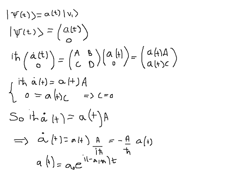

Hey drClaude,
There is given that we start with an statonairy eigenstate of the Hamiltonian,
H|v1} = E1|v1}
I will try to scan in how i tried the problem
for a: this is what i have so far(attachment)
and then i would fill in a(0)=1
so,
1=a(t)*e^0=a(t)
a(t)=1

I see, you are not told what the Hamiltonian looks like!
Your start is good, although I don't see why you are considering that the wave function is a two-component vector.
To continue, you should use the initial condition for ##a##, and probably also the time-independent Schrödinger equation in the quote above.

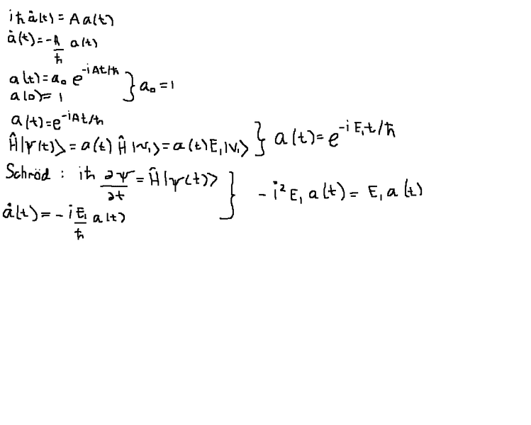

i \hbar \frac{\partial | \psi(t) \rangle}{\partial t} = \hat{H} \psi(t) = \hat{H}( a(t) | \nu_1 \rangle) = a(t) \hat{H}| \nu_1 \rangle
jennyjones said:
I don't get tho why i just can't say after i found a(t)=a_0 e^(-i(A/h_bar)t)
with the given condition condition a(0)=1
You have two unknowns in there that need to be determined, ##a_0## and ##A##. This is done using the equation I just wrote above and the condition that ##a(0) = 1##.
thanx DrClaude,
i'm going to give it another try!
Great, you have solved the first part:
a(t) =e^{-i E_1 t / \hbar}
You can move on to B.

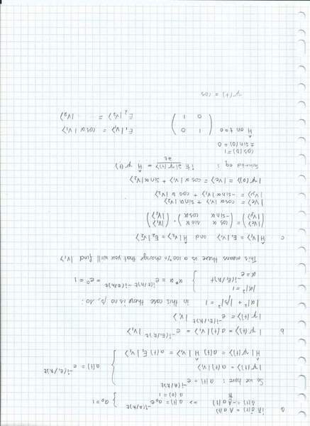

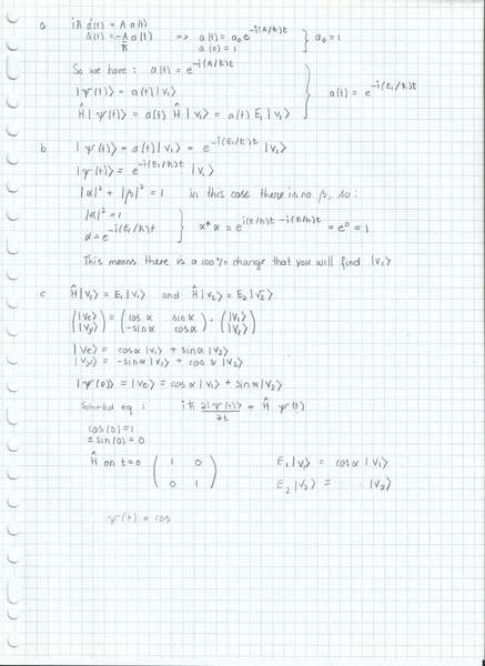

is it ok if i used the norming conditing to solve b?
no longer upside down
I think you have to.
In part B, it is not clear what ##\alpha## and ##\beta## are. I know what you mean, but I don't think it is a rigourous way of solving the problem. You should start by the definition of the probability of finding the system in a given state.
I will have a look at part C later.

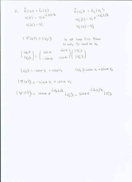

I think i solve c, or almost solved c
the thing I'm a bit worried about is that in my answer i get a -sin(alpha)
Btw i mistyped the assignment of c, the condition is |ψ(0)} = |v(μ)}
(instead of |ψ(0)} = |v(e)})
