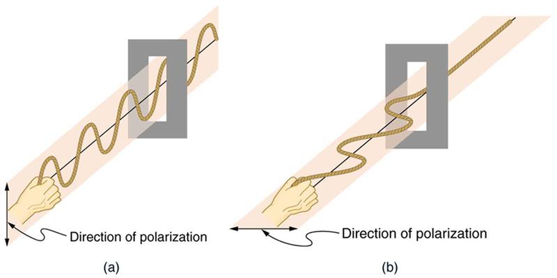

Consider my analogy for simplicity.
If I hold a rope on one end, and tie the other end to a pole in the distance. Between myself and the pole the rope runs through a gate( having vertical beams evenly spaced) placed between myself and the pole.
1.If I induce a vertical vibration (Y- pulse) on the rope . Then the pulse goes through the gate without any , disturbance. The energy of the pulse is totally transmitted through to the pole.
2.If I induce a horizontal vibration ( X- pulse) on the rope. The energy of the pulse is totally absorbed by the gate. No pulse energy is transmitted to the pole.
3. If I induce a diagonal vibration 45% to the horizontal and vertical. From simple vector analysis , I can calculate that a certain % of the energy will be transmitted to the pole.
We would find a substantially smaller pulse being transmitted to the pole, and the rest being absorbed/reflected at the gate.

Johan0001 said:
I was hoping my analogy, of the rope and gate , would simplify my question.
http://cnx.org/contents/0119fe7d-4d1a-42de-b580-aa46659f8228@4
There. Answers would likely be more to your satisfaction if your question was in Classical Physics section.
Johan0001 said:
Because if a photon does have these orthogonal fields which induce each other , the polarization explained using sinusoidal waves make no sense to me. I was hoping my analogy, of the rope and gate , would simplify my question. But it seems like we can only describe a photon using QM and classical interpretations are incorrect.
If this is true why are there so many references using these sinusoidal fields, to describe the nature of light or photons.
As others have mentioned above, these classical sinusoidal fields do have their quantum counterpart, and are called coherent states with a large average number of photons. The funny thing about them is that although they are made of photons, they do not have a definite number of photons - they are superpositions of states with different numbers of photon. So every time you measure the number of photons in a coherent state, you will get a different answer, but the average answer will be well defined.
Anyway, since this wave is essentially classical you can think of it as a classical wave with orthogonal fields. In this wave the electric fields and magentic fields are orthogonal to each other. When people talk about polarization, they are, by convention, referring to the just the electric component. So if you just concentrate on the electric component, you will see that it is sinusoidal and polarized along one direction.
thank you Johana , this is what I was using as my analogy , however it does seem like there is much more to a photon and its polarization.
Will need to take more time to have a better understanding.
