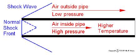

Diagram of a normal shock wave entering a pipe: outside the pipe air is at low pressure, while inside the pipe air is at high pressure and higher temperature, with a normal shock front drawn inside.
against what pressure produce thrust in ramjet if it is just hollow tube?
Ramjets can only operate at relatively high air speeds. The incoming air is compressed by a constricted mouth. Without that pressure, there is nothing to stop the exhaust from going out both ends.
So the short answer to your question is: the incoming air is compressed, raising the pressure, and acts as a barrier for the exhaust, causing it to only vent aft.
