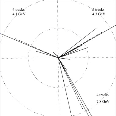

If there were no gluon, the number of events that look like the following is roughly zero.

If there were no gluon, the number of events tghat look like the following is roughly zero.
I thought that experiment was used to verify the existence of quarks. The explanation is that two of the jets were produced by quark-antiquark pairs that fragmented into hadrons. I don't see how we know that one of them was caused by a gluon.
No, the three-jet events are clear indications for gluons!

It does, the cross section (probability) of 3, 4, 5, ..jet events is best explained by the model of QCD.
There are also processes whos cross sections that depends on the gluon parton distribution functions, which fit the model of QCD more or less perfectly.
It is not only their existence, but also the rate of which 3-jet events are produced in comparison with 2 jet events.
Gluon is a spin one particle, so you get a certain angle distribution of the jets, which you can measure and compare with data. This is of course also been done.
