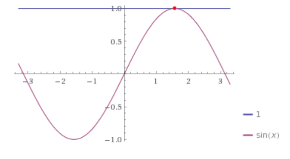

Ah I see. So how do you isolate e in this equation: ##x=A sin(\omega t+e)##? I don't remember how to do that where the variable is locked up in the sine function.
Plug in your two known values for position and time. This will get you ##25cm=Asin(e)## since ##\omega t## goes to zero. Knowing how a sin wave behaves, and that 25 centimeters is your max amplitude, you should then be able to solve for e.
well I did (0.25 m / 0.25 m) = sin(e) ----> 1=sin(e)

ikihi said:
well I did 0.25/0.25 = sin(e) ----> 1=sin(e)
Right, now take the inverse sin of both sides and you'll have e.

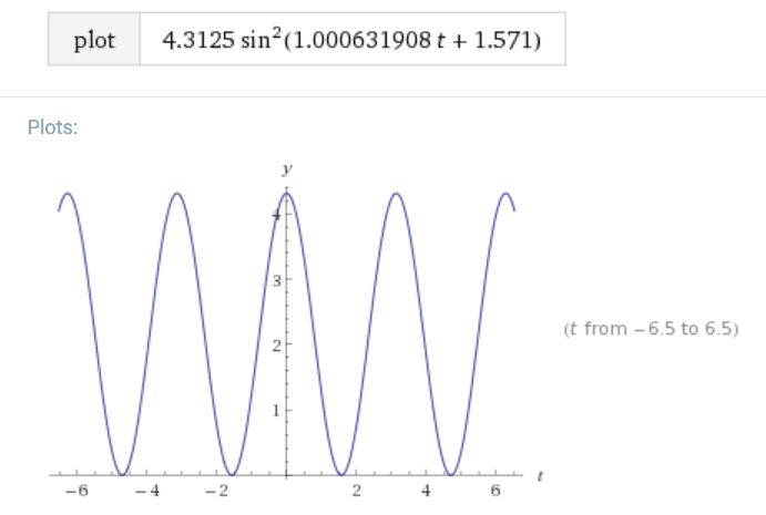

So is this the correct plot then?
ω= 2π / T ---> 1.000631908
u(t) = 0.5 * 138 * (0.25)2 * sin^2(1.000631908 ⋅ t +1.571)
simplifies to:
u(t) = 4.3125 * sin^2 (1.000631908 ⋅ t +1.571)

It looks right, except I'm confused about your value for ##\omega##. It should be equal to ##\frac {2\pi} T## where T is 1 such that it completes a full cycle every second. For the record, it's also usually easier (and more accurate) to keep things out of decimal form in your equations.

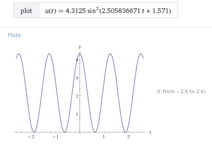

Ah I see. I had an error with my T.
ω should equal 2.51.
Here's the new graph:
  • Plot of u(t) = 4.3125 sin^2(2.505836671 t + 1.571) for t from -2.6 to 2.6, a periodic curve oscillating between 0 and about 4.3 on the y-axis, with t axis labelled from -2 to 2.

Still not quite right. Your ##\omega## should equal ##2\pi## if you want it to make one full cycle (from 25cm to -25cm back to 25cm) every second. This isn't a calculated value in this case. The problem statement specifies what they want the period to be.

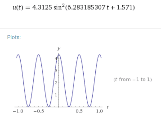

Okay so the period is 1 rev/sec since it's a clock right?
So ω= 2π/1 = 6.283185307
Here is the graph:
