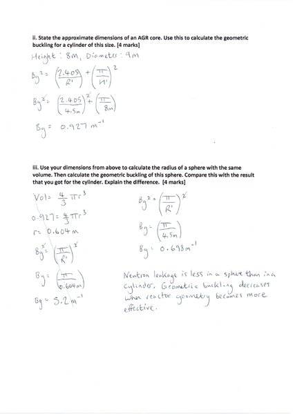

I'm very confused about the attached questions on geometric buckling of a cylinder and a sphere.
For this question I'm not given a value for the extrapolated distances (for R' and H') so I simply put the bare units in. The second question asks me to use a volume calculated from the first question, but my units are in m^-1.
I'm basically very confused about this question and any help would be much appreciated!
