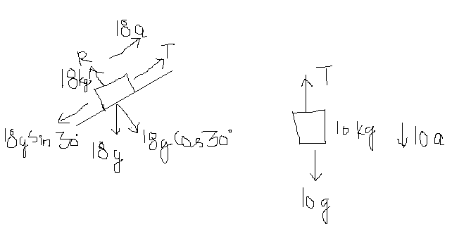

I'm having trouble solving this problem, someone want to help me out?
Two blocks are connected by a cord as shown:
Find the acceleration of the blocks.
http://img177.imageshack.us/img177/2554/physicshc9.jpg
I have the answer, but I don't know how to get to it.
the answer is 7.56
http://img264.imageshack.us/img264/5738/physicsww5.jpg
here is what i added
your free body diagram seems alright..
now apply the equation net force = mass * acc on both the bodies
ok here is the fbd. try solving the equations now. solve for "a" eliminating T.
one more thing, sorry for the pathetic condition of my drawing skills.
cheers
