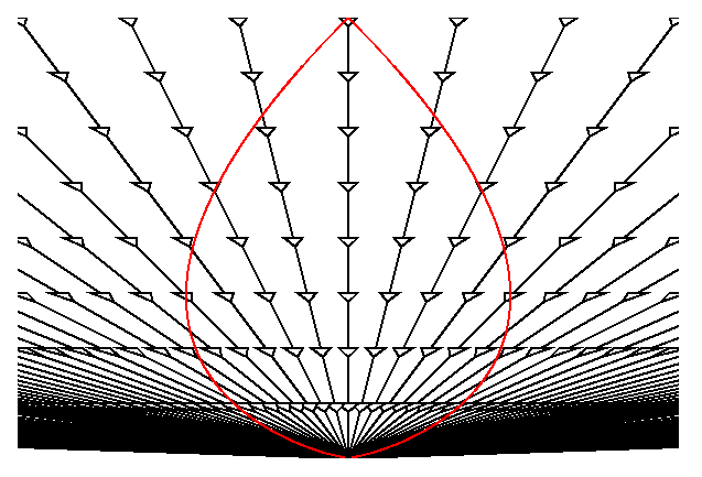

Also, I was drawing something and I want to know if it is correct.
The "0" 's are bodies, "-" is a photon.
Each row is a year.
Because of space expansion, the bodies are increasing their distance (relative to one another) at the speed of light.
The bodies are at first 3 light-years apart.
......0-...0
......0...-...0
........0...-...0
.......0...-..0
......0...-.0
......0...-0
......0.....0
Although the bodies were 3 light-years apart, the photon arrived in 6 years from the first to the second body and it shows the first body as it was 6 years ago. When the photon arrives, the bodies are now 9 light-years apart.
So, the photon traveled 6 light-years.
Is this correct?
Can those bodies be "at rest"? If not, my calculations are wrong, because if they move through space, time gets dilated.

Not really. For pictures of the path of a photon in an expanding universe, have a look at this diagram, taken Ned Wright's cosmology tutorial, part 2. Straight lines are co-moving galaxies, all expanding away from each other. Red lines are two photons, traveling in opposite directions. The vertical axis is time, from the bang at the bottom when everything is jammed up together. The little triangles are "light cones", showing the direction for photons emitted from one of the galaxies, both to the left and to the right.
Diagram of an expanding universe with time running upward: horizontal-spread lines of co-moving galaxies fan out from a point at the bottom, with light cone triangles along them, and a red curve marking a photon path that rises from the bottom point to the top.
Cheers -- sylas

What a pity, I missed this thread. I'll jump in with my usual agenda.
[...]So, the photon traveled 6 light-years.
Is this correct?
Essentially yes, but only if all your statements are meant to be defined in the reference frame you drew (the one where both galaxies have exactly the opposite velocity), and if you ignore gravity. It's a bit more complicated in real cosmology with curved spacetime and such.
At rest wrt each other? Definitely not. There is time dilation also, that's why your example works only in some special coordinates, like the one I told you.

Is there time dilation in space expansion if the bodies have the same mass (negligible mass) and remain "at rest" in respect to the CMB?
No. No such effect. You simply have the expansion redshift associated with the signals coming from A to B.
1+z = anow/athen
The parameter a is the scalefactor which appears in the metric and keeps track of expansion of distance. The ratio is that of distance now divided by distance then. The distance between A and B now when the light is received, over the distance then when the light was emitted.
So 1+z is the ratio by which the universe has expanded while the light is in transit.
That sums up the whole effect. Of course if we could watch them going about their business they would seem redder and be moving slower, because the whole movie is stretched out by the factor 1+z.
But my point is that this expansion redshift is the whole effect. There is no gravitational dilation and there is no motion dilation beyond this.
