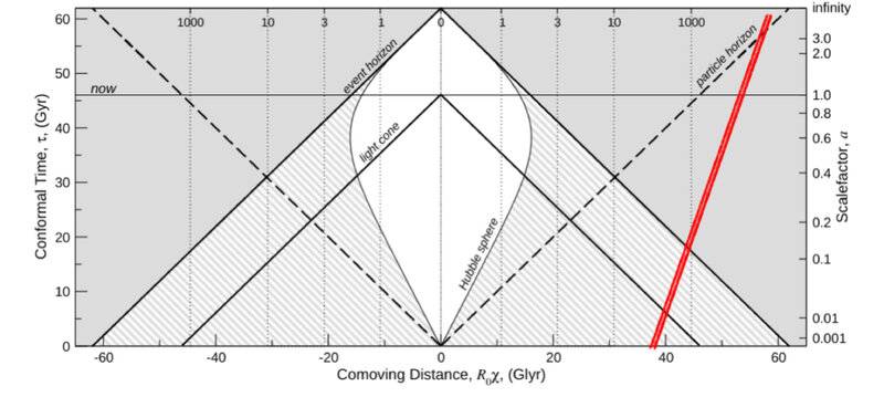

Is the particle horizon the boundary of the observable universe? Can some objects leave the observable universe? Can objects outside the observable universe influence the characteristics of objects we can observe?
In a recent discussion on the Cosmological Redshift in Simulated Universe thread, I claimed that the boundary of the observable universe is the particle horizon, that objects could enter the observable universe but could not leave it, and that objects outside the observable universe could not influence the characteristics of objects we can observe. @PeterDonis called these claims false or wrong.
In this regard, the Davis & Lineweaver 2003 paper (which has been referenced in plenty of PF threads) states:
"The particle horizon is the distance light can have travelled from t = 0 to a given time t" [Page 2]
"Currently observable light that has been travelling towards us since the beginning of the universe, was emitted from comoving positions that are now 46 Glyr from us." [Page 3]
"The particle horizon marks the size of our observable universe. It is the distance to the most distant object we can see at any particular time." [Page 4]
"[The] photons we receive that have infinite redshift were emitted by objects on our particle horizon." [Page 4]
"The particle horizon [...] marks the size of our observable universe because we cannot have received light from, or sent light to, anything beyond the particle horizon." [Page 9]
Given the above, is it false to claim that the boundary of the observable universe is the particle horizon? Is it wrong to claim that objects can enter the observable universe but can't leave it? Is it wrong to say that objects outside the observable universe can't influence the characteristics of objects we can observe?
Yes, if we adopt the interpretation that boundary means boundary in spacetime, which is the interpretation I will use in this post. The particle horizon line in the diagram in Figure 1 of Davis & Lineweaver is not the boundary in spacetime of the observable universe. The boundary in spacetime of the observable universe "now", i.e., all the events which we at distance "0" can observe "now", is the past light cone. The boundary in spacetime of the region containing all the events that will ever be observed by an observer at distance "0" is the event horizon.
Yes, but this does not mean the particle horizon line in the diagram is the boundary of the observable universe in spacetime. What it means is that the comoving distance at which the particle horizon line crosses the "now" surface is the same as the comoving distance at which the boundary of the past light cone crosses the "initial singularity" surface.
Yes. If you look at the diagram in Figure 1, it should be obvious that no worldline ever enters the region of spacetime bounded by the past light cone.
Jaime Rudas said:
but can't leave it?
Yes. The worldlines of objects can obviously leave the past light cone region of spacetime, and the event horizon region of spacetime, so that all we can see of the history of those objects, and all we will ever see of that history, is some initial segment.
Yes, because portions of their worldlines in the past can still be within our past light cone, even if their worldlines "now" are not.
The intersection between the particle horizon and the constant time surface "now" is the boundary of the region currently containing co-moving objects that have been in our past lightcone, yes. So objects can only enter it, not leave it, because the particle horizon is an outgoing null surface.
Note that this statement (very unfortunately in a paper which tries to correct misunderstandings) does invite a misunderstanding: that if we take an object whose worldline is just crossing the particle horizon "now", meaning that it is at a comoving distance that is just within our observable universe "now", we see that object as it is "now". Of course that is false: we see the object as it was just after the "initial singularity" surface in the diagram, since that is the portion of its worldline where the light we are seeing from it now was emitted.
In other words, the statement quoted above invites the interpretation that our "observable universe" is a region of space, instead of a region of spacetime. But when we focus on what we can actually see, on the light that is actually reaching us from distant objects, which in turn determines what can affect us causally, it should be obvious that in practice, the region of spacetime that contains events within our past light cone is the region that is actually relevant. I do find it unfortunate that this point is not made clearly in the otherwise very useful paper by Davis & Lineweaver.
Ibix said:
the boundary of the region containing co-moving objects that have been in our past lightcone, yes. So objects can only enter it, not leave it, because the particle horizon is an outgoing null surface.
To put this another way: the set of comoving objects whose worldlines have some portion within our past light cone always gets larger, not smaller. So it is possible, if we use the term "observable universe" to mean something like "the set of comoving objects whose worldlines we can see some portion of", to say that objects can only enter our observable universe, not leave it.
However, as I said in previous posts, I think this interpretation invites other misunderstandings, which is unfortunate in a paper that is trying to correct misunderstandings.
So you call my statement false because you interpreted it completely wrong?
False. The limit of the observable universe "now" is a sphere of radius 46 Gly centered on the observer and, in cosmology, this limit is called the (current) particle horizon.
Yes, that is obvious, but what I am referring to is the observable universe that you insist on confusing with "the region of spacetime bounded by the past light cone".

Jaime Rudas said:
False.
No, my statement was not false. It was just referring to something different than what you are referring to.
And this is not a boundary in spacetime. It is a boundary in space in the spacelike hypersurface labeled "now" in the diagram. The boundary in spacetime of the spacetime region containing events that we can observe is what I stated.

Jaime Rudas said:
Can you provide some reference that indicates that the observable universe isn't a region of space, but a region of spacetime?
Tong's notes define (p16)$$d_H=ca(t)\int_0^t\frac{dt'}{a(t')}$$This is clearly an increasing quantity in an expanding universe, and this is immediately followed by "[t]his is the size of the observable universe". That is consistent with your interpretation of "observable universe" and Davis & Lineweaver. However, Tong goes on to say (p17, literally the next paragraph) that "[t]he distance ##d_H## is sometimes referred to as the particle horizon" and then adds that "nothing outside the particle horizon can influence us today". Coupled with figure 8 (p18), it looks like Tong is here regarding the particle horizon as what Davis & Lineweaver's figure 1 labels the light cone - and this is consistent with Peter's interpretation of "observable universe".
So, unless I'm very much misreading Tong, even reputable sources can get in a contradictory mess with terminology in two consecutive paragraphs. So I would advise a cautious and flexible reading of anything on this topic.
So, unless I'm very much misreading Tong, .
I think you are misinterpreting Tong. What Tong's figure 8 shows does not contradict what the bottom panel of Davis & Lineweaver's figure 1 shows. Perhaps the only difference is that Tong does not show how the particle horizon evolves over time, but only shows the distance to it at present.
But Tong says "nothing outside the particle horizon can influence us today". That's a description of our past light cone.
To be fair, the statement is also true of events now that are outside what you and Davis and Lineweaver call the observable universe. But it is also true of events now that are inside it - so on your reading Tong's statement is vacuous.
I think you are misunderstanding Tong again. He is not referring to whether current events within the particle horizon can influence us now, but rather whether objects that are or are not within the particle horizon today can or cannot influence us now. That is, the possibility that past events of those objects can influence us now.

As a complement to my post #23, I note that Davis & Lineweaver in 3.4 and figure 3 (lower panel) carry out a detailed analysis of the drawbacks of representing the particle horizon as the dashed vertical line in Tong's figure 8.
Jaime Rudas said:
it is not true that we were referring to different things.
Yes, we were. I was using the term "observable universe" to refer to a region in spacetime. You were using it to refer to a region in space. As I've pointed out once already, I have agreed that we were talking past each other in the other thread. I have also apologized for the confusion on my part as to what we were each using the term "observable universe" to refer to. Given all that, I would appreciate it if you would stop arguing over this point.
All that said, "observable universe" is just words. Words are not physics. As far as I can see, we have no disagreement about the actual physics--what can causally affect what, what things we can actually observe or not. But if you do still have questions about the physics which you think have not been resolved, that is what I think we should focus on.
